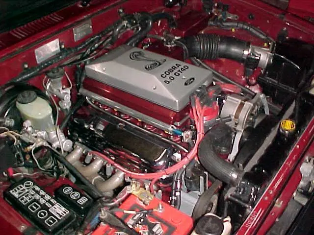

This is what you want. I got it from a US Mustang shop as it is a proper gauge for the schrader valve etc. As it screws on a pin contacts the valve and opens it and vice versa when you unscrew it the valve shuts.
Its super handy as it can be installed or removed in seconds. You can see it installed in this pic as I also fitted the schrader valve to larger rails for this reason.
Just checked it and its made by Performance Fuel Systems (USA) and there is a number on it 9085-01.
