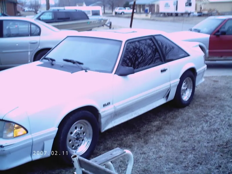

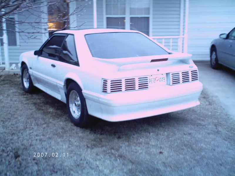

mine arent prostars but are weld rims and will look similar and it will give u an idea.
i would get a 15x8 with a 5.5" BS on them. really tucks under the fender good.
heres my car with that size rim
i am running a 255/60 tire they dont LOOK as wide because they are a taller tire.
but u can pretty easily fit a 275/50 tire on, you will have to take the quadshocks off. with the 255s u can get away with flipping them but with 275 i duno for sure.
just try and see.
