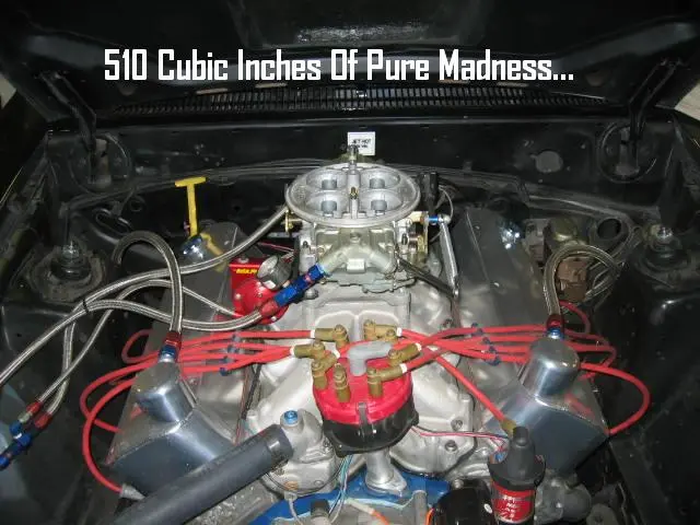

btw, where did you get the parts for the conversion and did you buy them separately or as a kit, ive been throwing around the idea of doing that same swap and was curious about the best way to do it
I used to work at a mustang shop, so most of the swap parts are the FRPP swap ones. Mounts, oil pan, radiator are all ford racing. The serpentine setup is homemade, works great. Most everything else was just used over from the 5.0 or "modded" to work.

A bigblock fox is just evil. I love it. If the end of the world ever really happens, armegeden.... a fox with a bigblock will play some kind of role in it. :D Car looks wicked, just the bigblock fills the engine bay so well.
