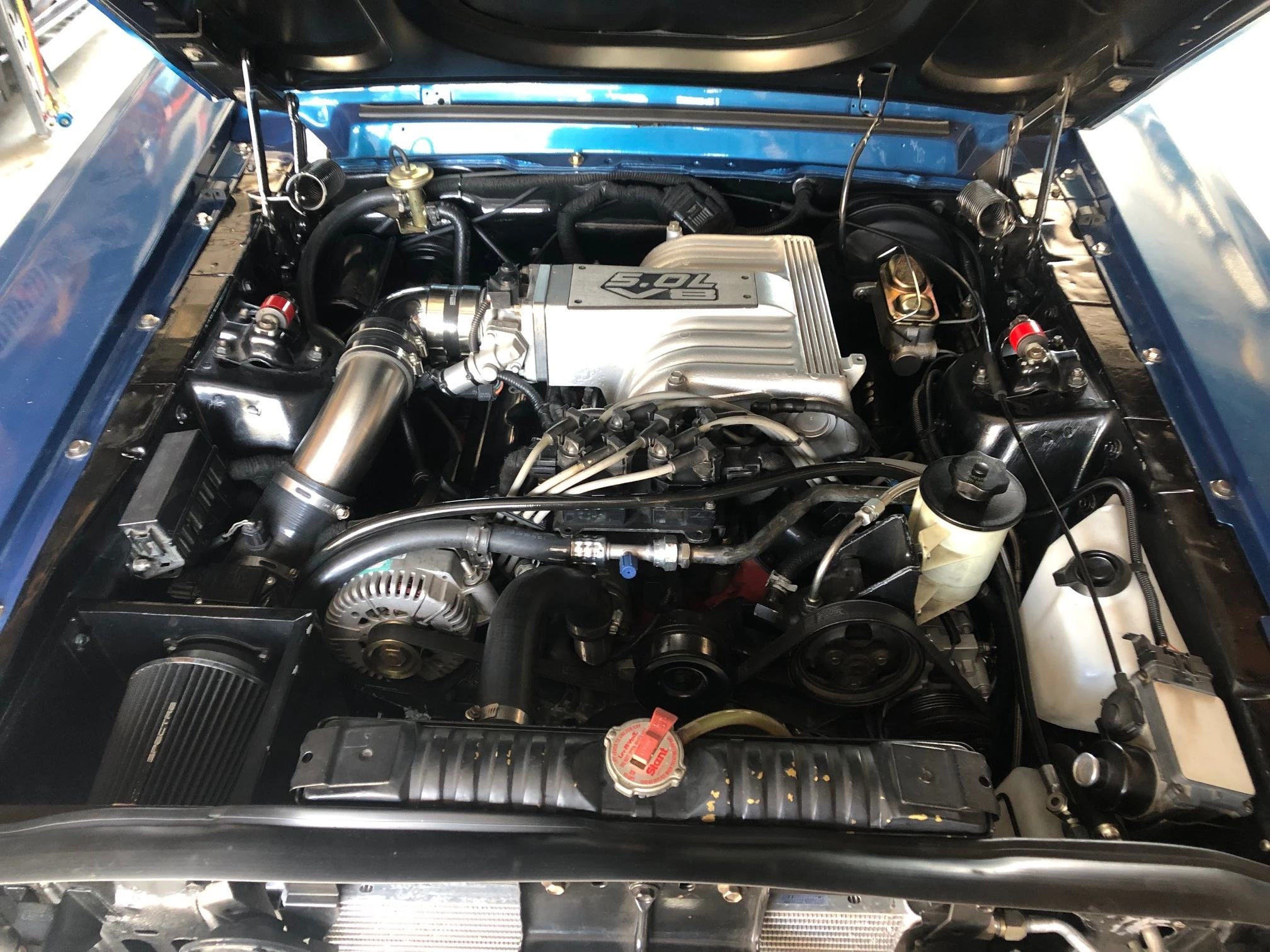

I recently completed Swapping 97 ford explorer 5.0L with GT40p head and 4R70W E-AOD tranny.
I modified the Explorer's existing wiring harness and got video instructions on youtube. My 67 Mustang now has 5.0L fuel injected with AODE Transmission
Very nice!!!
