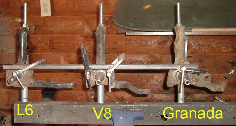

I do have a very weird situation on my car, let me explain. It`s a factory 6 cyl car ( T code) with a 5 lug V-8 suspension. The rear end tag and the transmission tags match completely, however, other than the 5 lug suspension, it has the 6 cyl front end parts, all the way from tie rods to the steering box, which is pretty weird, being as they did not make sprint editions until 66. I`m wondering if my 5 lug spindles that were attached to the I-6 tie rods are the same as the V-8 spindles? Would the tie rod hole be the only difference if there was a difference?
Is there a casting number on the spindle I can look for to find this out?
This has actually been bugging me for 8 years.
The spindles your speaking of are on your 65? Do you have pictures? Because what could've been done is use any where from 67-69 6cyl spindle on your car . They are the same spindle as v8 but use 6cyl hub aka 4 lug pattern. There for anyone with these can switch the drum out for a v8 five lug drum easily
