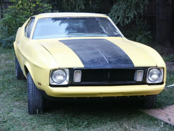

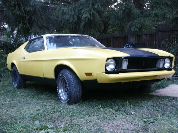

Well folks, she ain't perfect, not completely done, but now moving in and out of the garage under her own power, as well as sporting a yellow and black paint job (even if it is a 20 footer, and needs a washing)!!

Thanks everyone! It's been a long 5 years, and we aren't done yet. This is a "for now" rattle can paint job, that was mostly to see what color yellow we wanted to go with (medium bright is out, a version of Chrome is in-but it's over a grey base, so it's more zinc than chrome). The hood is closest to chrome and is on a yellow base, and it's a bit too "orangey" for us. We're thinking more of a Grabber Yellow. We still have a 10 point cage in our garage waiting on the guy to weld it in. We need to figure out a steering column issue, and an iginition problem (probably the switch). She needs a finished exhaust (cuts off right after the axle right now, thanks to the guy that did the pans-he had to though, it was right against them)....and probably a couple dozen more little things (including getting the grill to align properly with the hood, which also needs a little tweaking).
To quote Gone "she's sure been a lot of trouble...probably because she's the last of the Mustangs....sure is a pretty color though" Maindrian Pace, Gone in 60 Seconds, in reference to Eleanor
(although I don't agree that she's "the Last Of the Mustangs").
This car is kinda like the movie was. Not a big budget "professional" thing-a bunch of friends helped us build her (the one guy that did the major welding work's mother went to school with Halicki-how's that for a coincidence), and with the exception of the motor, tranny and some welding work (pans & pass quarter, full replacment including wheel houses, and eventually the roll cage), everything's been done at our house, by us or with help from friends.

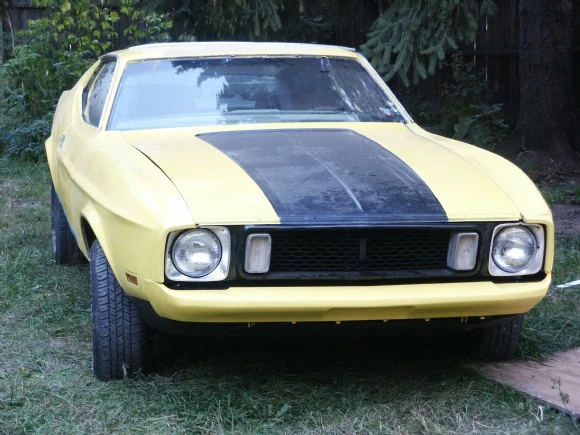

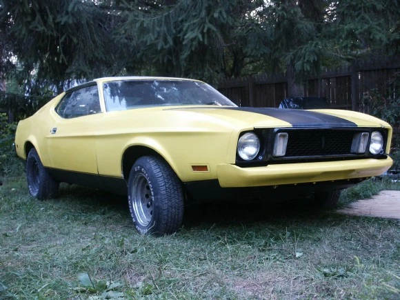

You can see them on Eleanor in this pic:
The quarter extension is painted black, but the rubber piece is still yellow.
As far as worth, it depends on where you are and how bad it is. Options can also effect the price-like a/c, the gauge pack, fold dow rear seat, Mach trim level...Eleanor was about as basic of a Mach as you can get (didn't even have the nasa hood-which would have worked out well, except we had to replace it anyway, base level trim-as in the standard seats and door panels, no gauge pack, no ac) I've seen ones that were as rough or worse than Eleanor was go on ebay for over $1500. We paid less than $1000 and they dropped her off at our house for us.
