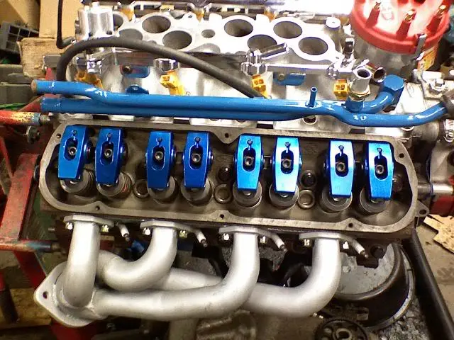

Someone else may have had the same idea, because someone started to unbolt the upper manifold (either that or they just needed the bolts)...
See the little hole in the middle of the intake, thats the egr passage, there should be one on the upper and lower. If its non egr then it will be blank. And those are GT40 heads btw.
If it is from 96 its almost guarnteed to be Internal....but you should still pull the upper off and look as i just pulled a internal egr intake of a 97 mountainer that had a External egr tube coming from the manifold on it. we thought at fist it was a mid 97 (when we saw the tube) which is when they swapped over to external and GT-40P style.
even the 96 Explorers used the external EGR system in the 90 degrees elbow (mine from a 96 did) but for some reason, Ford had the EGR passages cast into the upper and lower intake even though they used the external EGR system. Much to our benefit.
