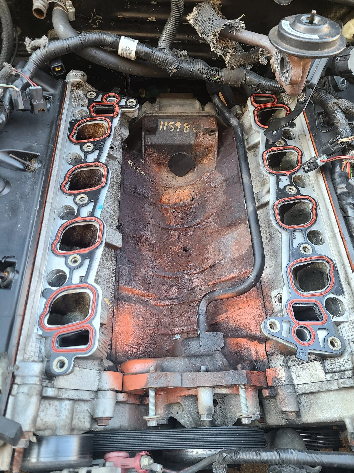

Are there any visual differences between PI heads from 99+ mustangs and regular 4.6 liter heads from a 97 mustang? Just wondering if there are ways to tell by looking under the hood.
The only way I know of is to look at the intake openings. PI heads have a rectangular opening and the older heads had a teardrop/oval opening. I don't know of another way.

I have the bullitt intake and was told that an 01 bullitt engine was put in my 97, I figured the only way to be sure that the bullitt intake wasn't slapped onto the 97 engine was if I could confirm that the PI heads were on there (even though that wouldn't necessarily guarantee the car has had the bullitt engine swapped, it would be much more likely).
