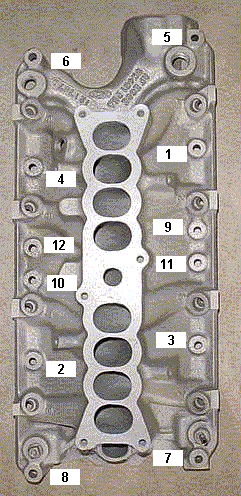

Inspect every inch of vacuum hose there is in the car. That includes under the dash where it connects to the HVAC controls. Check the PVC hose and grommet. Remove the upper intake and check the gasket and manifold surfaces. Check the torque on the lower intake manifold bolts. Use a shop manual to get the odd bolt pattern and torque values.
