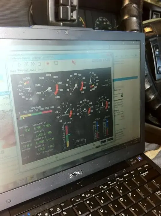

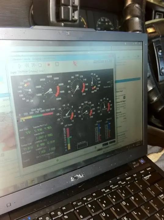

We through a lot of mods at the 92GT, if we didn't have the twEECer it wouldn't even be running. I know exactly what your going through. Being able to visually see the TPS volts, MAF volts, Injector Pulse Width, O2 Temps, fuel pressure, timing, etc. was so essential. We were able to adjust everything correctly and now its idles like a champ. So worth the $400. I wasn't a believer until this project. I would have been adjusting and adjusting still and probably wouldn't have hit it.
