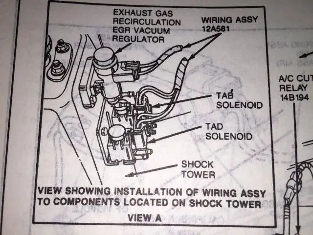

Like mentioned above, if the smog equipment has been deleted from the car then you can remove the TAD/TAB solenoids. The larger round solenoid is for the EGR if that's been removed then might as well yank that as well.
*edit added pic

My smog pump was deleted on my car sometime in the past. The previous owner left some of the piping and vacuum lines though. So I removed all the unnecessary stuff to clean it up, but I left the TAD/TAB. My understanding is that removing them will set a internal code in the computer.
This is correct but doesn't cause a CEL and doesn't effect performance. Pretty much the same as having the smog pump deleted. No CEL but an internal code stored.
