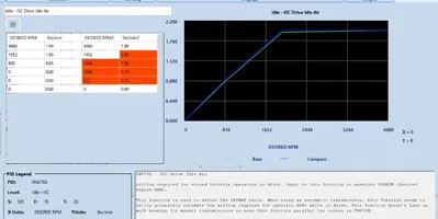

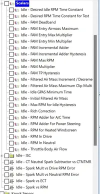

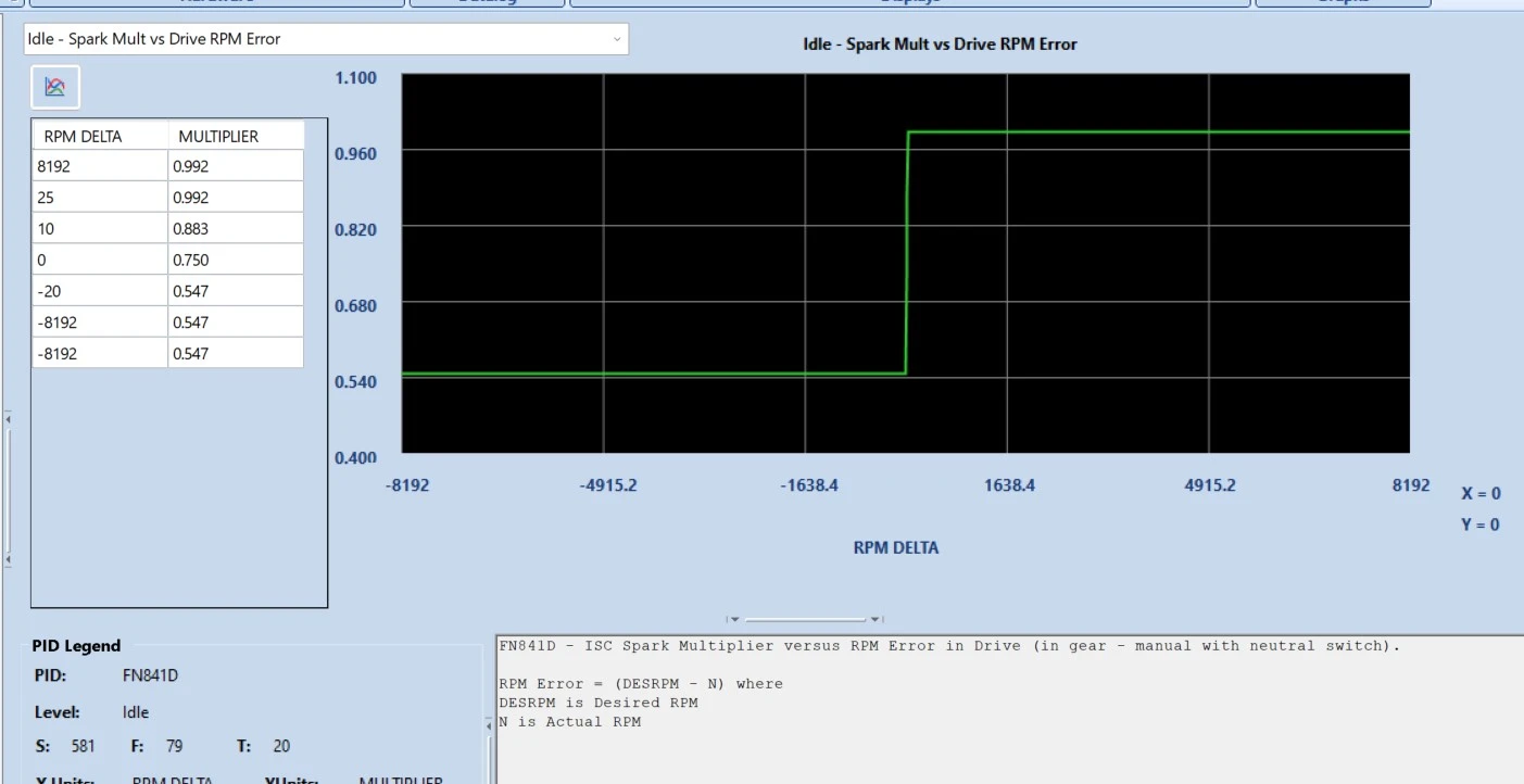

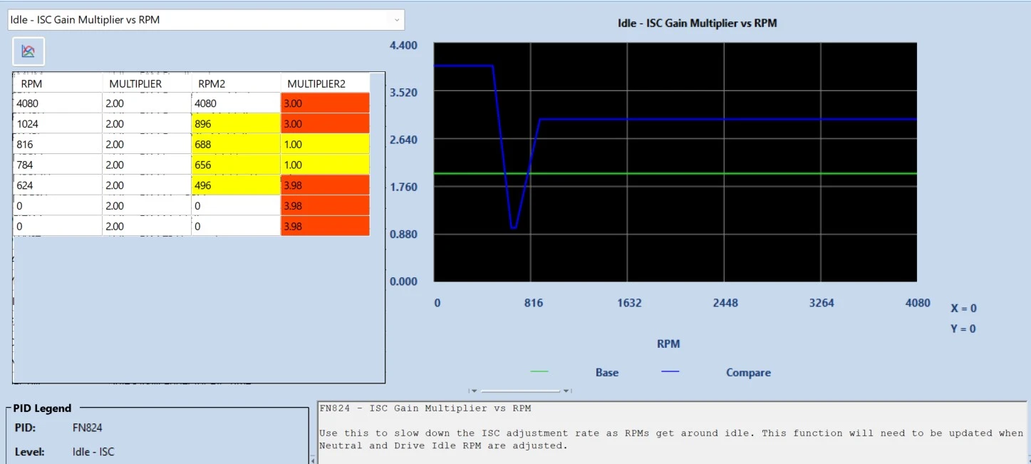

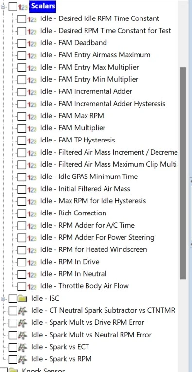

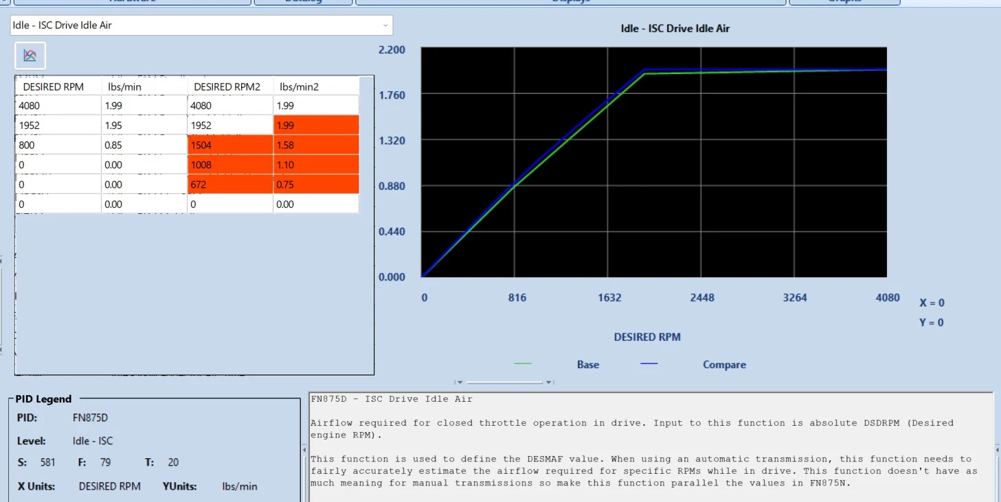

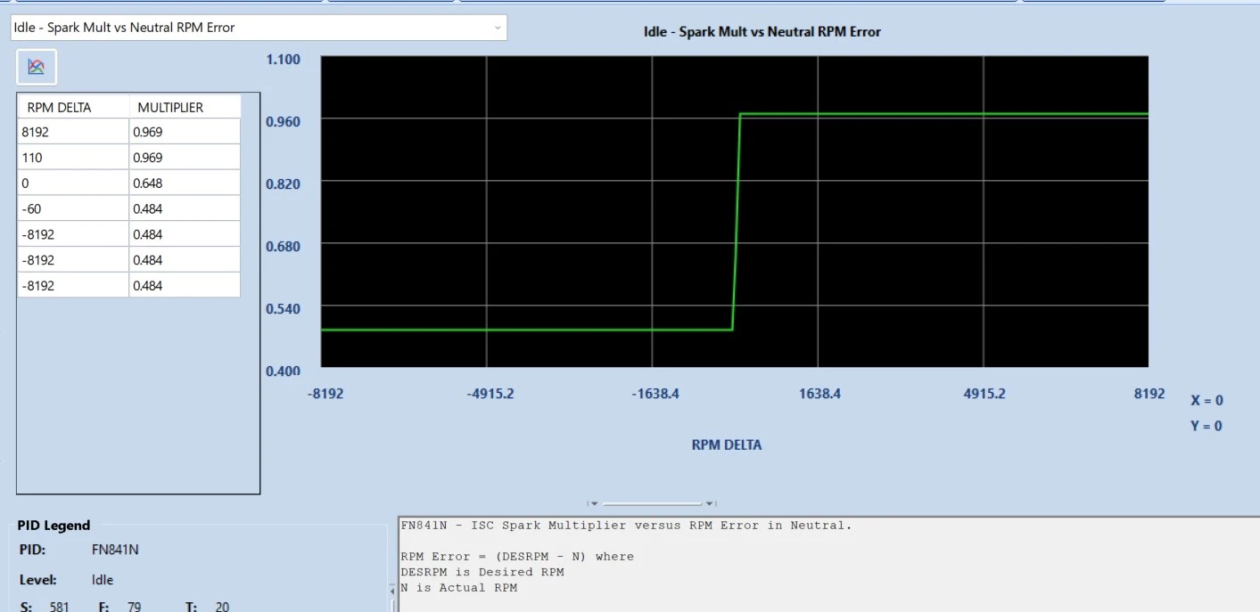

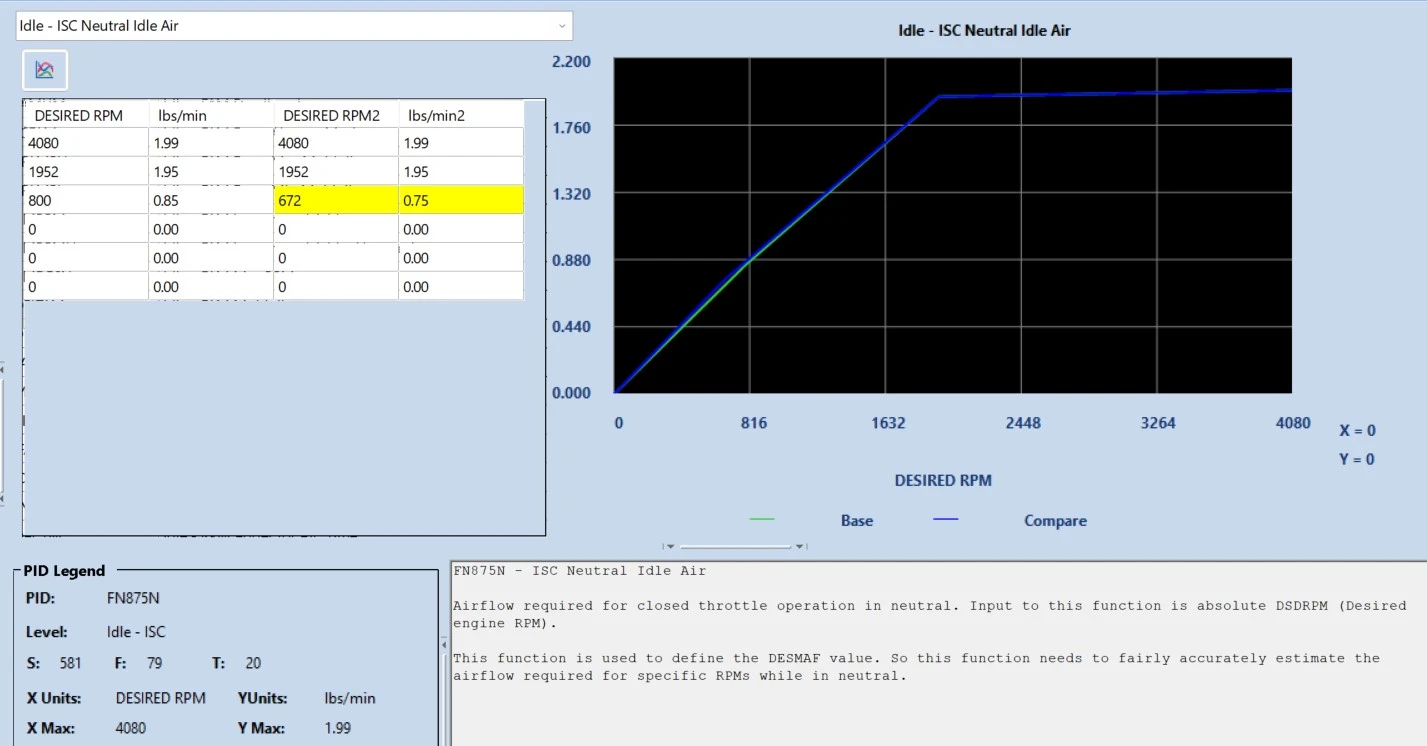

Sounds like you may be having an issue with the AOD selector sensor..When your ECU doesnt sense whether its in Neutral or Park is a pretty conflicting issue for a vehicle with an automatic when the vehicle is going 45mph or registering as being in Drive when in its actually in Park or Neutral as with an automatic the computer has settings for both and it affects idle , fueling and spark advance etc due to there being different spark tables the ECU follows........

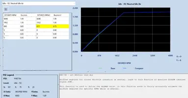

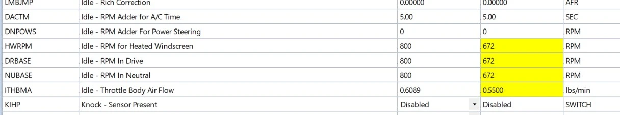

In a stickshift this is less of an issue but when you look Ford created an idle issue with the A9L and everyone who bypasses the clutchswitch by connecting it together is running off of the neutral tables and the ones who just disconnect it are always in the drive side unless you have a chip and can make both the exact same...
In a vehicle with an automatic the idle aswell as spark must be manipulated to get a smooth gear selection then be manipulated to adjust to the load of the torque converter at standstill and under load

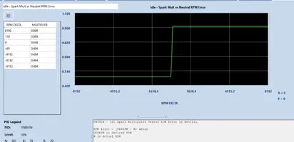

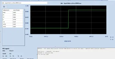

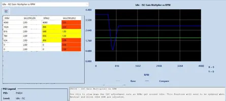

I had to change these in my tune to match in neutral and drive due to having a stickshift but the ones on the right are stock A9L settings...Even though theyre the same with drive being more comprehensive just pushing the clutch and releasing it gave me a small idle differential when pushed then released until I made both exactly the same...
Screenshot 2024-06-25 143536.jpg Screenshot 2024-06-25 143521.jpg Screenshot 2024-06-29 182044.webp Screenshot 2024-06-29 182028.webp

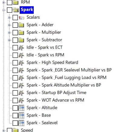

There are 3 spark tables too and the base is the enhanced table to get the engine up to speed from a dead standstill than switches over to either the sealevel or the altitude table to save the engine from damage from timing thats too far advanced in the lower load areas of the timing table altitude and sealevel timing tables..
