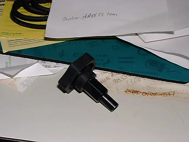

7/32 deep well thin wall should be what you need. here is what my TFI tool looks like:
