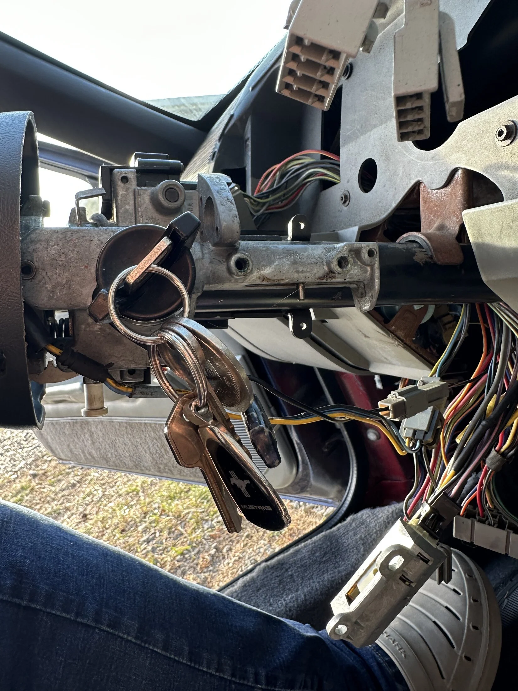

I didn’t have it out I just pulled the whole steering column out and the only time I even engaged any of it was when I was putting it back in and put the key in so I could rotate the steering wheel freely. What would cause it not to move it all the way?

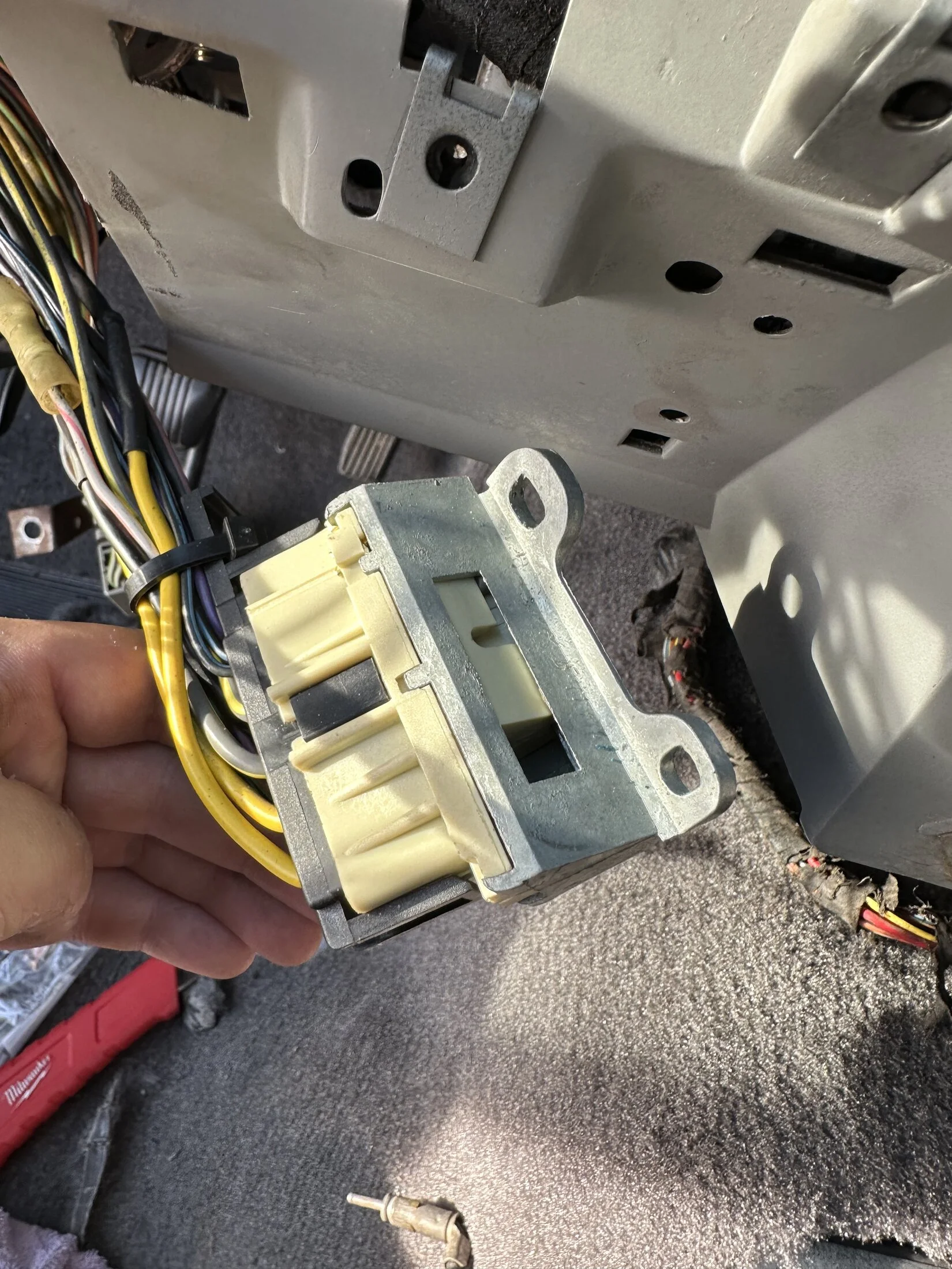

This is the location of the pin and the ignition switch slider when the key is in the on position
There is a rod that connects the key switch to the ignition switch, you may have dislocated it from its proper spot on the ignition switch down on the column, pull the switch off the column and take a screwdriver and move the switch mechanism

I pulled the ignition switch off again and the rod won’t move unless I put the key in and turn it past the steering wheel lock then i can move it freely and the key turns with it. The little rod thing lines up with the insert on the ignition switch. I just did some probably not so correct testing and took the ignition switch off and with it still hooked up used a screwdriver to push it all the way forward and I’m able to get it to prime but even with the clutch in and pushed as far forward as I physically can I have no crank.

Okay so I did some more testing and I unhooked the starter connector that goes into the clutch safety switch and jumped it then I cranked the car and it actually cranked. It also started for a second but the car is slap out of gas so it died a few seconds later . Still however it will not prime with the key in the on position and primes right before cranking happens. I also tried the method general karthief suggested by taking out the ignition cylinder while in the on position and then turning it with a screwdriver but for some reason I couldn’t get it to budge.

So you’re right. I pulled the key tumbler and for the life of me can not get the rod to move with a flat head. I’m just wondering how it would’ve gotten misaligned considering none of the ignition components have been tampered with at all since I installed the new ignition switch which worked fine. I also did another test and unscrewed the ignition switch and dropped it off the column and pushed the plastic slider with a screwdriver and it has several distinct clicks in it for ACC, off, ignition on, and when pushed all the way, crank. The pump will only prime and the cluster will only fully light up in between the ignition on click and the crank click. The switch is also starting to separate which is just wonderful.

Okay so new ignition switch is in and even though the old one fully separated, it wasn’t the issue. I also took the snap ring and retainer plate out of the tumbler housing and pulled the whole rod out to check for damage and all is in good shape. I’m at a complete loss. The spring, pawl, gear, and guide rod are all in tact and even though the spring isn’t the springiest anymore it still holds the pawl in place. The gear was also not misaligned or out of place.
Once I took the retainer plate out of place I was able to use a flat blade to turn it and it exhibited the exact same behavior. All the key on functions only happen in between the on click and the run click and will only stay running if I hold it in the on sweet spot. If I let go of the screw driver it just springs back and shuts off the car.
