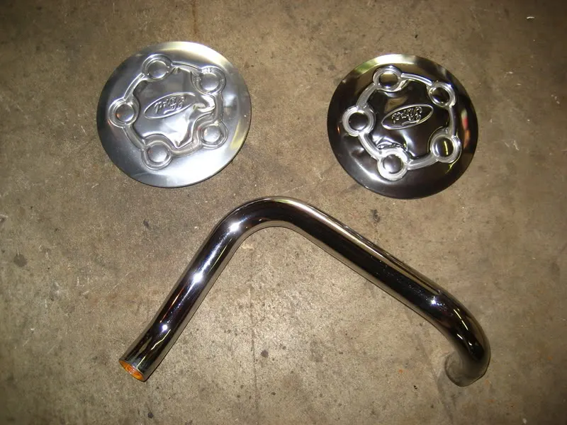

Recently I came across a unique method to get a very near chrome look called Elektra Chrome! It is a 3 step process which includes an acrylic paint as well as powdercoat. I think the pictures speak for themseleves!!

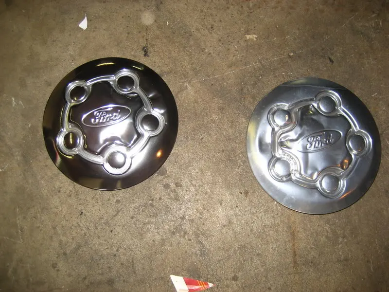

I used two spare centercaps I had laying around, in the first pic you see the "almost chrome" on the right, and the Elektra Chrome on the left. In the second pic along with the hubcaps is an actual chrome plated piece for comparison.
This was my first shot at using the stuff and it turned out a little rough and I know with a little more practice I could make it look much better. Also, it does not yet have a gloss clear powdercoat on it yet which would probably bring out the shine even more.
I estimated the total cost for this piece to be about $5.50, and about 30 minutes in labor (not counting the time the piece is in the oven).

The depth and reflection depends very much on the basecoat and the final clear coat. The better the basecoat is, the better the results will be. On this piece my basecoat was a little poor. I also did not put a clear powder coat on it yet, and I think that will help a lot.
The piece I just did does not have quite the depth and reflection of an actual chrome plated piece, but it is very very close. I really think with more practice I could get it nearly identical to chrome!
