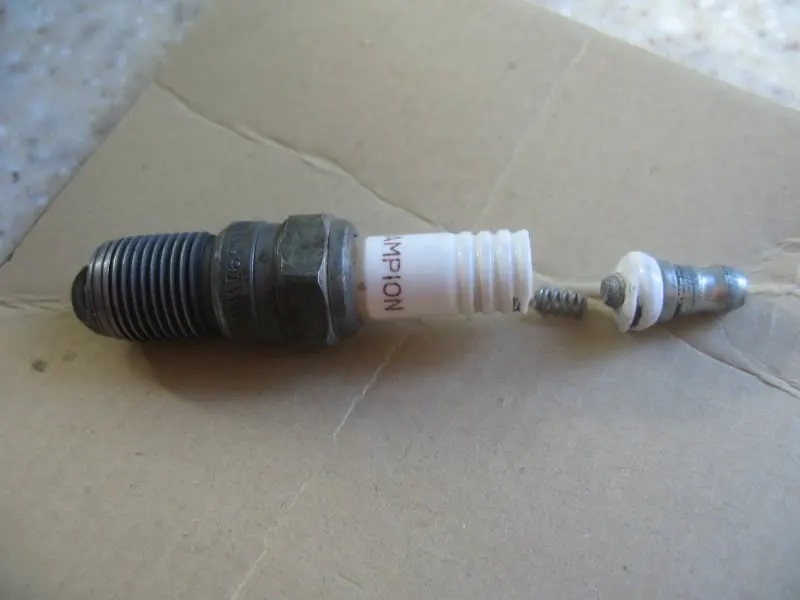

I got there and went right to the plug location that had the problem the last time and found the plug in pieces in it's cavity..... there are no threads for sure left on the head....I pulled another plug and it just slipped right down in there without screwing in....
Before i go on.......here's a link to what happened originally with this car...
http://forums.stangnet.com/showthread.php?t=704158&highlight=hotstang46
and here's a pic of the plug after I pulled it out today
What are my options here guys? What all you guys think is damaged...do I timesert, new heads (completely uneducated on heads)? what should i do and or have to do?

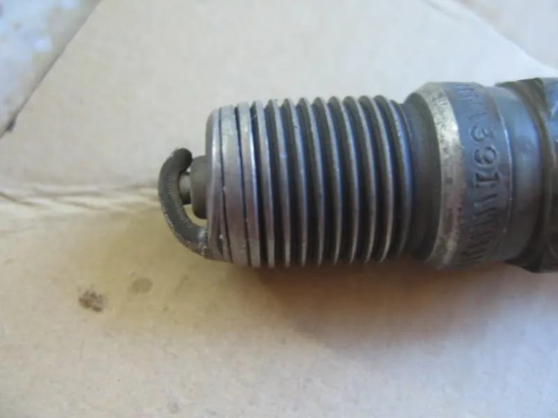

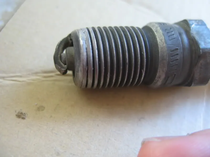

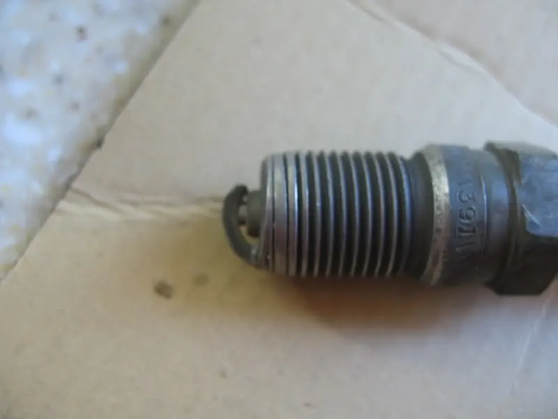

Hey I checked that spark plug number that is showing in your pics and that is the wrong plugs for your car. The threads are wrong and too long so your piston is smashing them from what I gather. The champion number is a 401 not a 391. Might want to verify it I checked with a local parts dealer and they confirmed it.
well isn't that interesting.....i bought that plug at my local auto zone.....I'm going to have to investigate this further.....
If it turns out that it's the wrong plug shame on me for not double checking.....but shame on those bastards for giving me the wrong plug.......I'm not quite sure about what I can do about it now though if it turns out they sold me the wrong plug.....I'm almost sure I don't have the receipt...but I will look..
none the less....the car is now sitting in my garage and I have no idea what my options are or how to proceed:shrug:

I can't even find any info out about a 391 plug, discontinued maybe?.....but i found a pic of a motorcraft plug for my car and it matches the champions that are in the car.... strange that the picture you have there says it's a 401...i looked on their sight and saw that was the applicable plug for car.....:shrug: I'll try to call em tomorrow....
It is a discontinued plug is what they told me.
It is in fact the right plug......just got off the phone with champion.... the 391 reading on the plug they told me is not the Part #....it is the one that begins with R, they just said it was old stock.....
