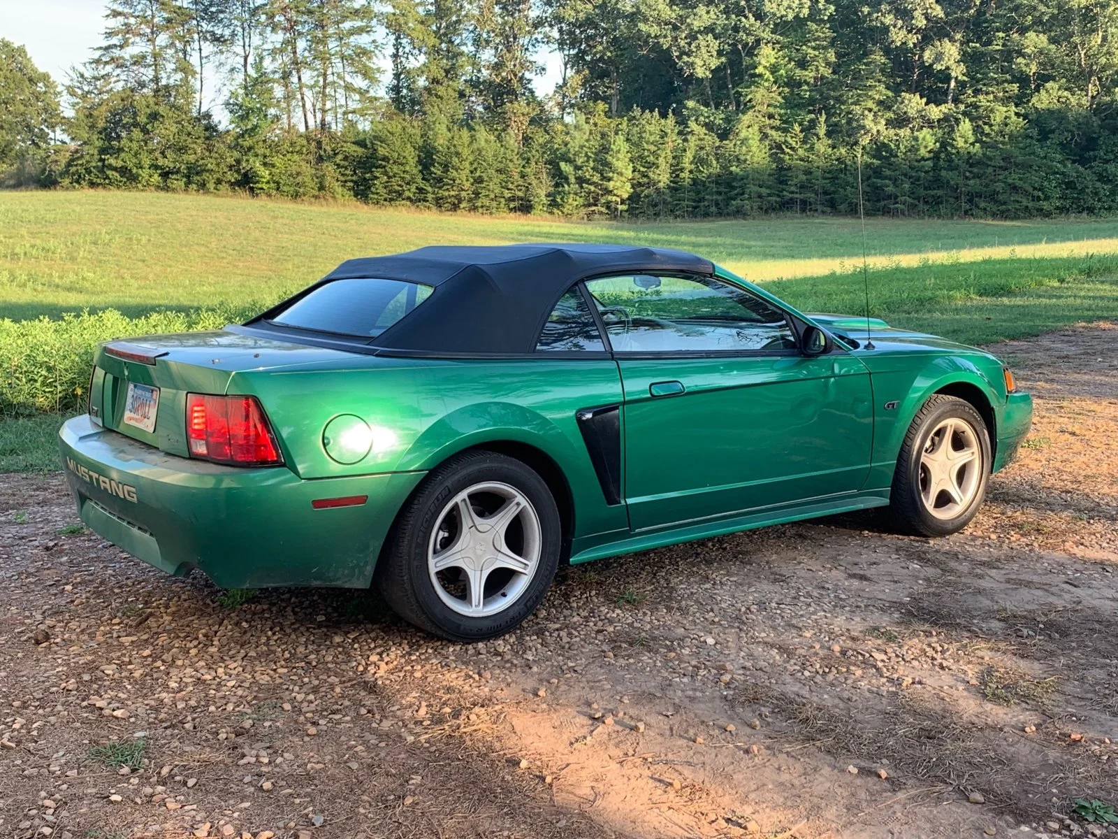

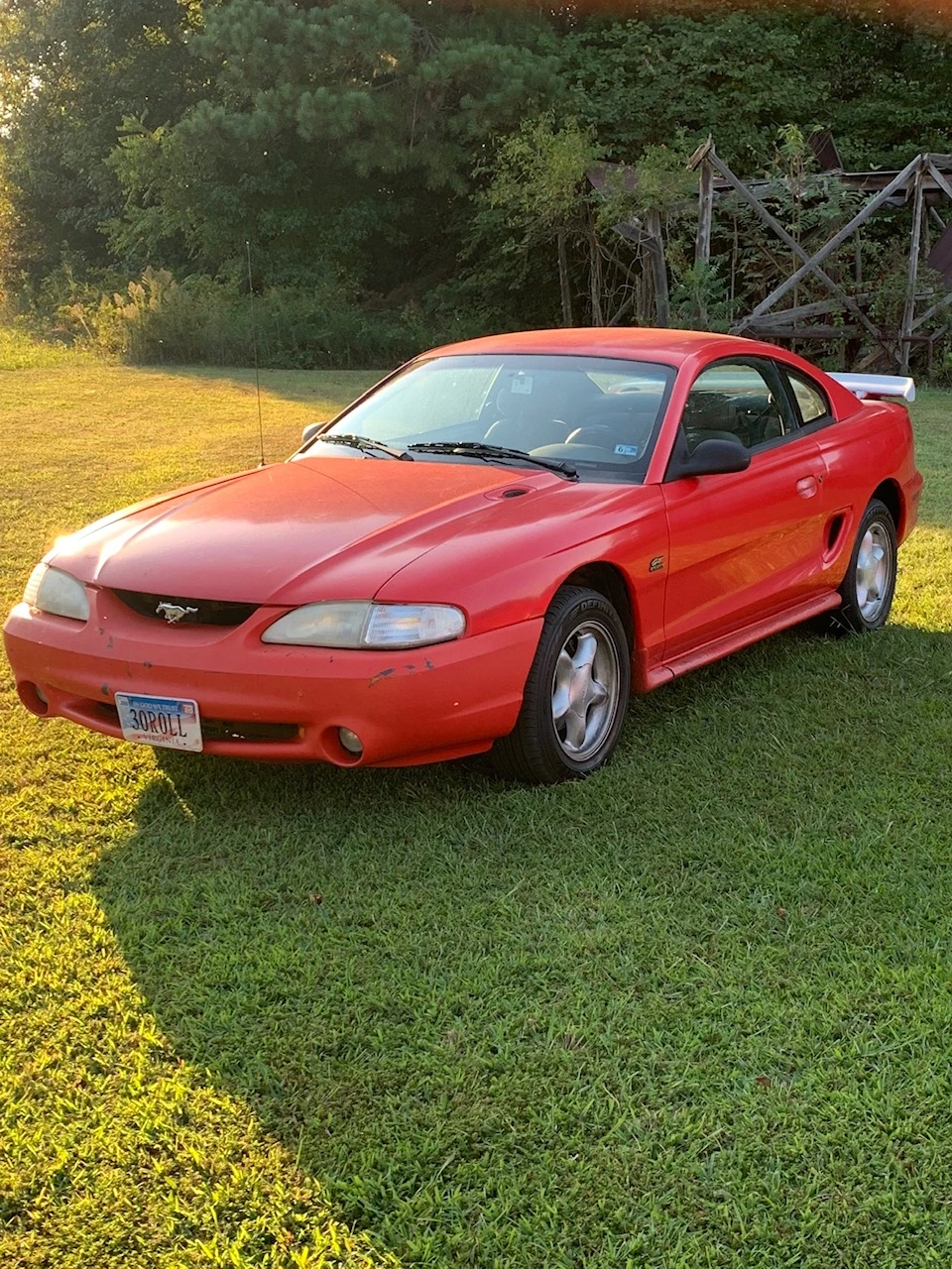

I made the guy well aware of its history, I don't screw other over with a problem car without being transparent. He actually was the one that offered the trade and I drove mine 1.5 hours to his house to make the trade, it ran perfect, but... it was 78-80 degrees, not 95-100 and that's when it has its issues.... I think he wants a project 5.0..... and brother... you got one....
This is the 95... and the 01 we traded for....

Traded the top one for the bottom one...
