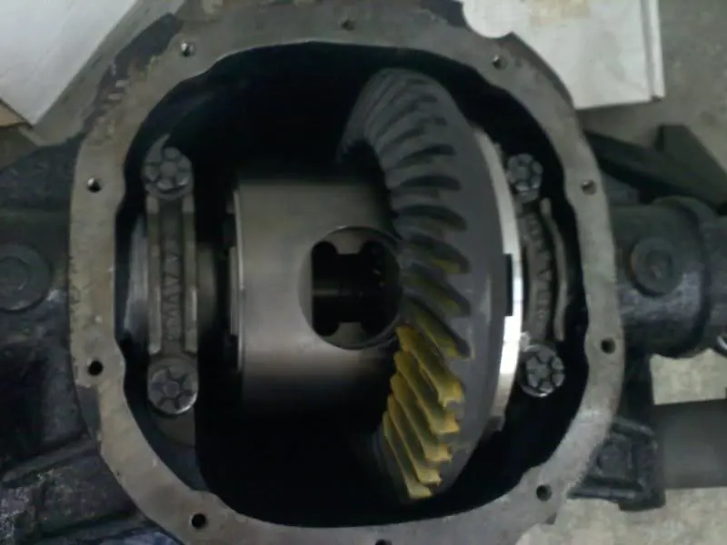

Ring and pinion are setup. Now I'm just waiting on the axles and studs to arrive. I'll probably update everything in my other thread....
http://www.stangnet.com/mustang-forums/threads/shes-whipped-back-into-shape-again-pics.850742/
One thing that concerns me...I have a DVD on how to re-build the Ford 8.8 axle. In the DVD the guy says that the carrier caps should have the arrows pointing outward, but mine are pointing inward. I told the guys building it that the caps had probably lost their correct place over the years, so I didn't know which cap went to which side. He said they had ways of finding out, so hopefully they know what they're doing.
