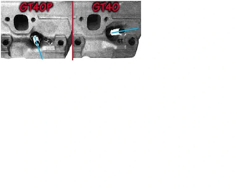

Identifying GT40 heads
Revised 26 may 2018 to include spark plug angle pictures and text descriptions.
The GT40X are aluminum. The GT40 & GT40P heads are iron. Use a magnet and it will stick to iron, it will not stick to aluminum.
GT40 heads have 3 bars cast into the front or rear sides of the heads.
attachments\604454
GT40P heads have 4 bars cast into the front or rear sides of the heads.
attachments\589096
attachments\605996
GT40 heads have angled spark plugs, flow slightly less than GT40P. Stock and aftermarket headers fit with no problems.
GT40P heads have flow slightly more than GT40. The straight spark plugs mean that some aftermarket headers don't fit properly and spark plug wiring may be very close to the headers and burn easily.
