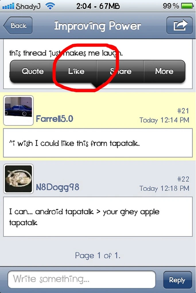

^i wish I could like this from tapatalk.
I can... android tapatalk > your ghey apple tapatalk
Hey Nate, swallow this pile of nasty... And enjoy my apple screenshot.
