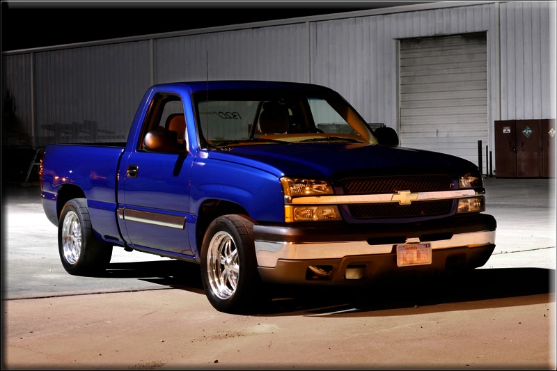

This is not about the mod motor though, look at a 351. How much would need to be spent to make 350 to 400hp out of it? How much would need to be spent to bring the small block 351 with 1 more cubic inch of displacement to the abilities of a stock 350hp LS1 that will hang around 6200 to 6700rpm all day without a problem? See then you take that amount and buy stuff for the LS1 also. With a $4000 budget which would make more power a LS1 or a 351w?
408RWHP on a stock 03-04?? That's really good. I've seen 380-390 and I thought that was high. He must have a strong car and be in a good spot as far as elevation/tempurature are concerned.
I dunno man. It just is what it is. :shrug: I don;t think he was concerned about sea level or anything. Md is probably average. The car just puts out those numbers but I could care less either way really. They just seem to pump out a lot.
