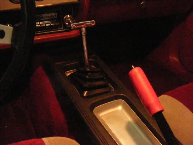

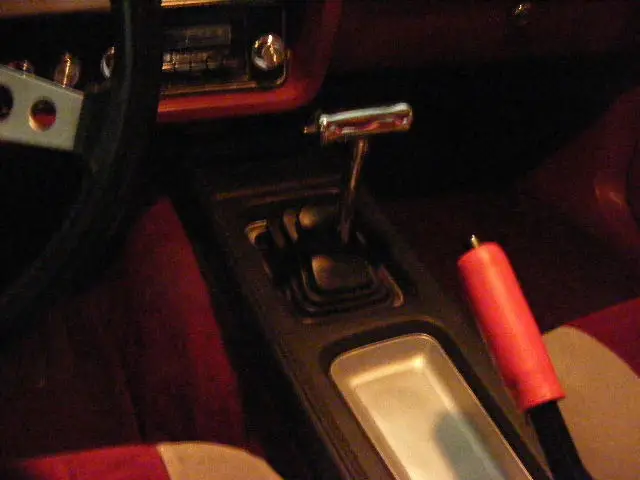

I have no problem shifting with the stock shifter it's detents are positive and it has the reverse lock out, just add a small Hurst boot and you can still retain the the center console. Just slide the rubber boot over your shifter pod and replace the console can't beat the look for $10.00.
