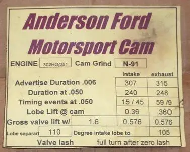

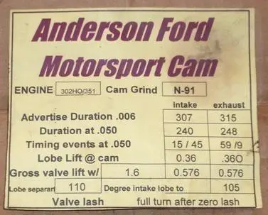

Car sounds sick btw. What kind of cam you running? Sounds good.
Thanks. It's an Anderson Ford Motorsports N-91.
