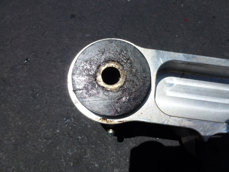

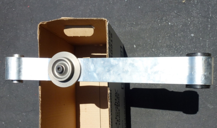

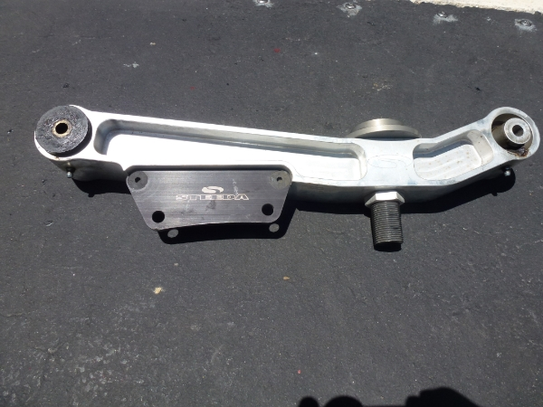

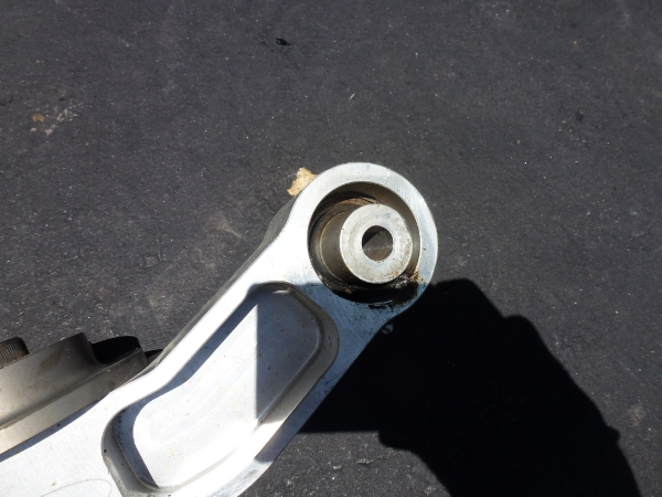

I have a set of Steeda weight Jacker style rear lower control arms with what look like solid poly bushing and a spherical busning on the other end.
I was wondering if I should run them as is or try to get them rebushinged? I want the benifit of ride hieght adjustability.
Also, I notice that the swaybar attachment may be a bit different on these pieces than on my stock 86Gt. Will I be needing a new rear swaybar to mate to these lowers?

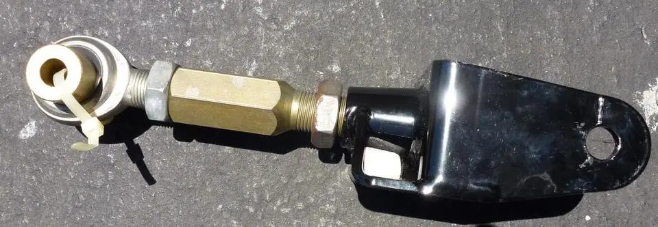

In addition: The other phot is of a set of upper adjustable control arms that I think I shouldn't run at all - tell me i'm right or talk me into running them.

Looks to me like the lower is missing some bushing... ???
The lower sway bar attachement is there, ready for your stock bar if you like.
