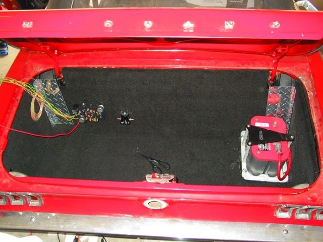

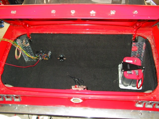

I am in the process (still) of putting an 18-circuit universal painless kit in my 67. One of the options you can get for that kit is the trunk mounted fuse panel. I got that option plus the trunk mounted battery and solenoid. The painless kit is of outstanding quality and each wire is well labelled. I only have two complaints...one, the manual is way to generic and you are going to have to figure most of it out yourself...two, when any manufacturer says their kit is "universal" that really means it is not a direct fit for "anything" :D
Here's a pic of my fuse box:

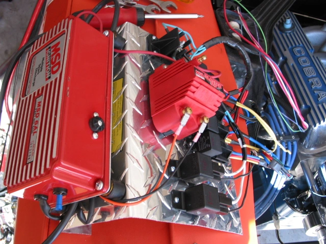

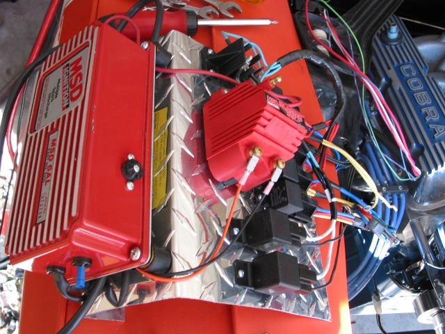

I had little choice but to use a universal kit due to all the things I have that are not stock. In fact the painless kit did not even provide for some of them so I made this "brain center" thing to handle all the relays and junction blocks:

Dave - as Edbert said they do have a trunk mount option which I am probably going to get if I go custom, If not I was going to go with the 67 9when it comes out) and then add an extra 4 circuit piece for my extras.
Edbert - Keep uus updated on how your install goes and tips/tricks. Also what did you use to make your trunk surround? MDF?
