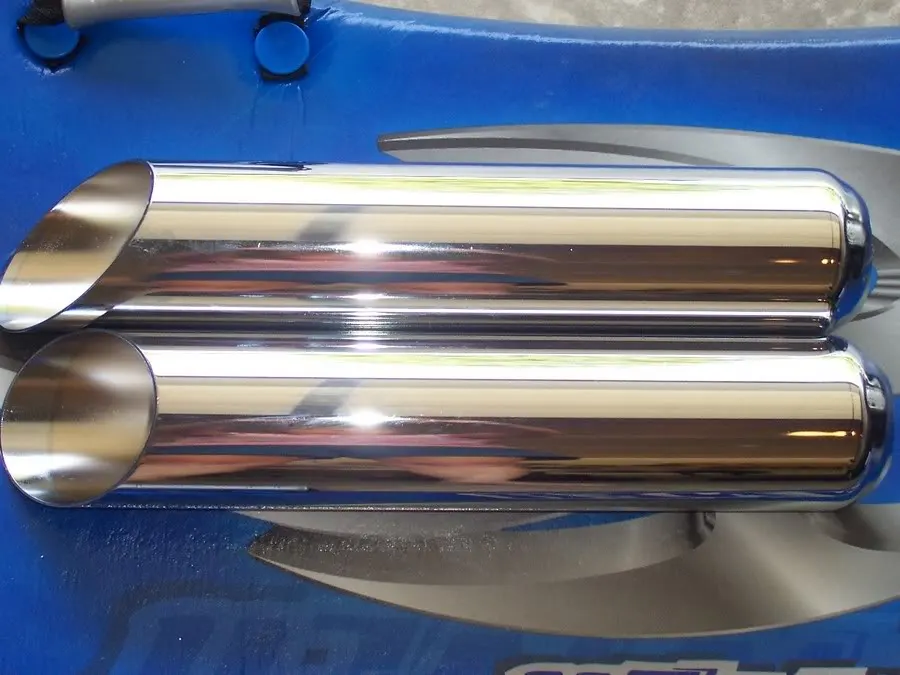

Maybe your 97 is different but before I purchased my tips for my 02 I measured the pipe right at the back of the factory tip and it was 2.25". The tips I purchased were 18" by 3.5" chrome angle-cut tips with 2.25" inlet and they fit perfect.

nie looking tips, maybe im wrong, ill see again i guess, i have to go back to the shop to measure :(
