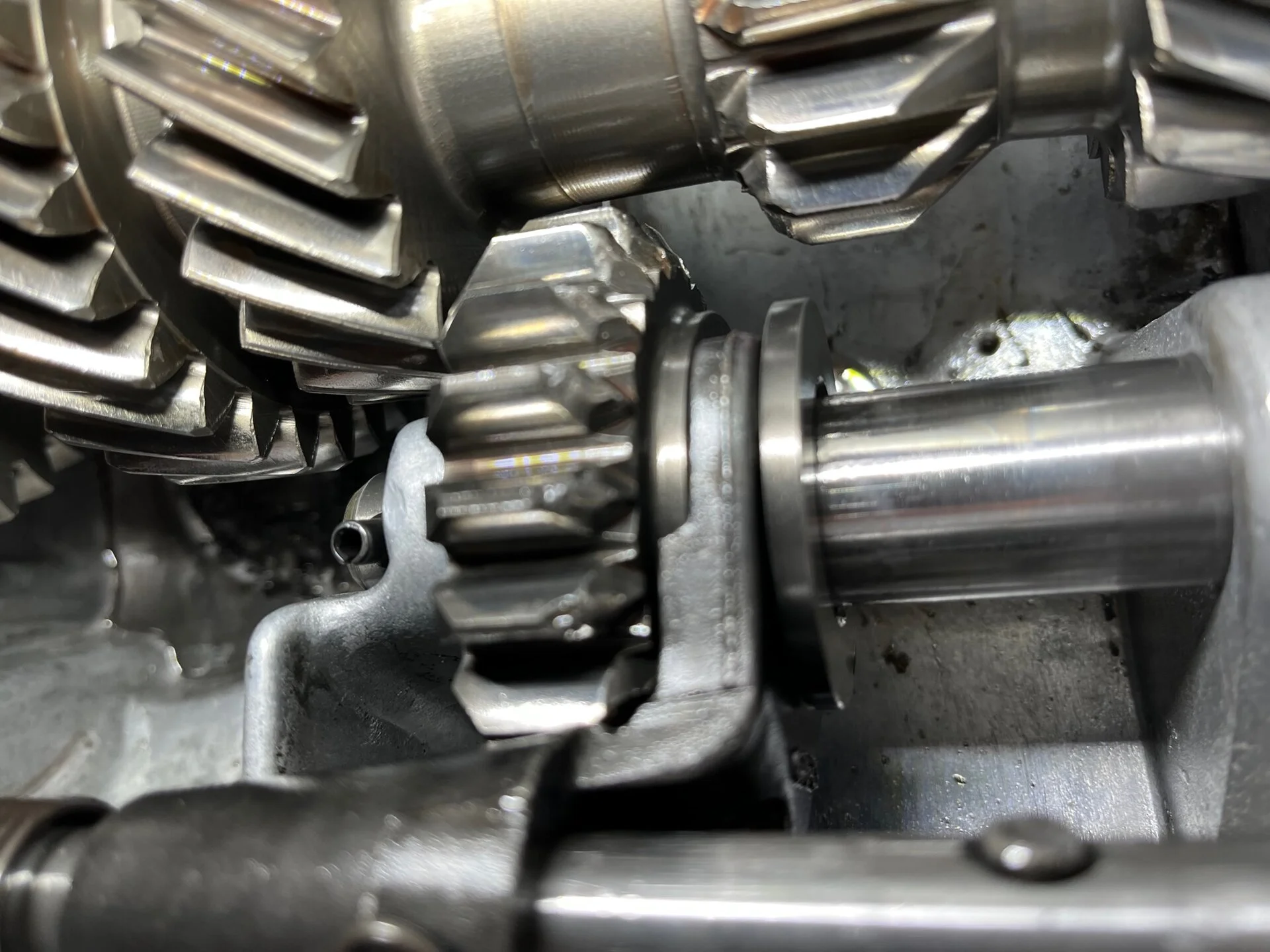

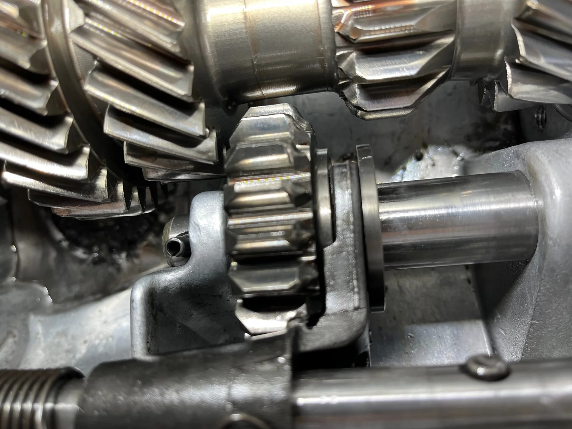

Ok, decided to pull the main gear shaft out and make sure the case was really clean. The reverse gear idler looks worn to me. Should I go ahead and replace it while I'm in there? aside from that, I believe I'm ready to clean it up and put it together. Gonna give it a very detailed inspection in the morning to see if anything else looks damaged.
this is turning into a pain in the butt. At least I'm not on a time crunch.

I can't say for a T5, but years ago I "redid" my muncie 4 speed in a Z28 I had... The reverse idler looked about the same.. I cleaned up the edges a bit and reused it... Worked fine, a little noisey but what reverse gears aren't??
eh, that’s borderline enough that I probably wouldn’t replace it.
That damage is from trying to jam the trans into reverse while everything is still spinning, rather than go for a forward gear first and then reverse.
Later T5s got a reverse synchronizer so this was less of an issue.
If you had a good reverse idler, I’d swap it while there, but if not I’d just send it.
Reactions: General karthief
