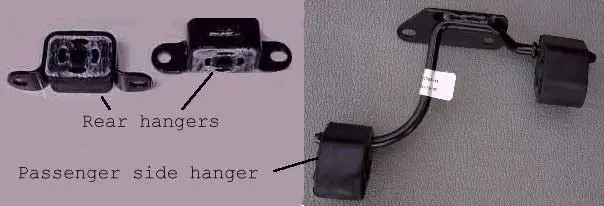

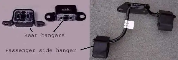

Those are the tip hangers. They go into the rubber pieces that bolt onto your rear bumper frame. They hold up the exhaust tips via the L-shaped bracket, which will bolt onto the top of the exhaust tip itself. Install went fairly easy for me and my dad. Maybe about 1.5-2 hours, most of which was spent cutting out the previous exhaust system, which is welded together (only had 18" jack stands, not enough to just slide it out, had to use an OLD school Dremel to cut the metal :/).

See my attachment:
1: long bolt that's threaded on the inside
2: L bracket
3: bolt that holds L bracket to rear bumper frame
4: bolt that holds exhaust tip to L bracket
5: Exhaust tip
And yes, you need 2 muffler hangers and 2 exhaust tip hangers (metal brackets with rubber pieces with a circle cutout in the middle where the metal 'rungs' slide into).
You need these:
The circular holes are what the long studs slide into to hold the exhaust tip in place.

are you sure the tip hangers go in the original place cause if that's the case then it doesn't look like the tips are gonna look right cause they're not going to be sticking out from the bumper at all? i feel like a tard, i haven't asked this many questions about anything on any car ever. could someone just post a picture of the tip hangers on please? i know where the muffler hanger goes but i'm confused on the tips.
