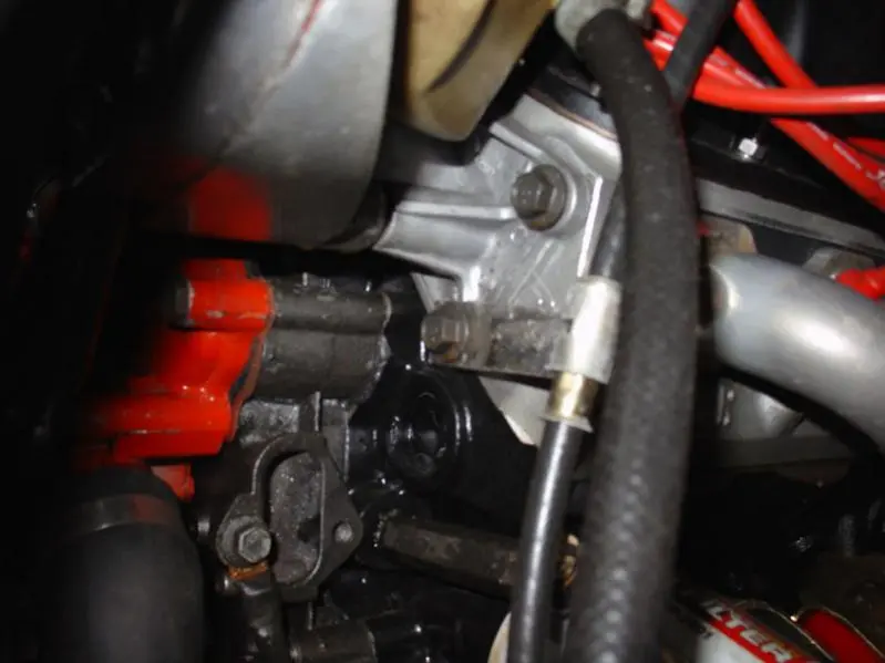

I had the same issue with mine, i ended up mounting it to the front of the cylinder head. Made the overall radius of the bend of the clutch cable to be as wide as possible.
I forgot to mention I had this same problem just like Swede958 mention with the metal bracket on the cable too far from the original cable location. I have to get under the hood again and look for another location for a wide angle for the cable. I may try the cylinder head location too if it work great for you.

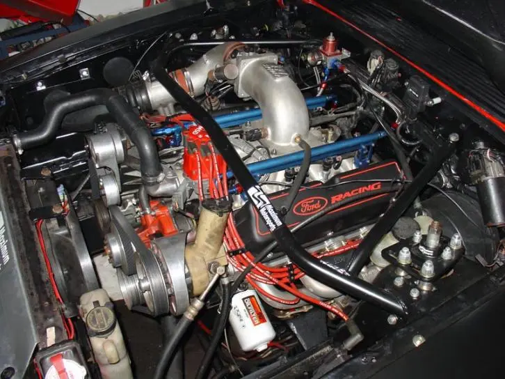

I also dont have my AC installed anymore, so i had a lot more acess to the bolts, not sure how this would work if you still have the AC/PS attached.
Here is a few pics so you can get a better idea
First shows where the bracket bolts up on my cylinder head, second shows the large radius on the cable that it creates.

I wouldn't keep that cable that close to the exhaust. The heat exposure will shorten its lifespan quite a bit.
The stock (or at least the most common) mounting point for the bracket is near the mounting point for the bracket holding the power steering pressure hose, below and slightly rear of the battery tray on '86+ EFI models. (Don't have any pics handy here at work, unfortunately.) It keeps the cable as far away from the exhaust as possible without routing it in such a way as to create bind.
In a pinch, I suppose you could always zip-tie the cable to something on the frame. There's a lot of holes there where you could loop a zip-tie or two through there and use that just to hold it back from the exhaust, but eventually, you'll probably want to rig up something more permanent with metal.
