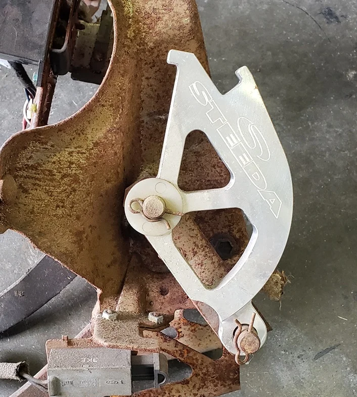

The quadrant ramp you're looking for is the one that looks most like the OEM quadrant. It's about as round as you can get it with no flat surfaces leading ot the curve.
Quick Release Style:
More Gradual:

The quadrant in the car is a Steeda.... picture of actual quadrant:
Anybody recognize this one and have any info on it?

If it was me I would call Modern Driveline and talk to them about the order and they might be able to look it up and see which clutch they sold you. From there they could even recommend a different one.
