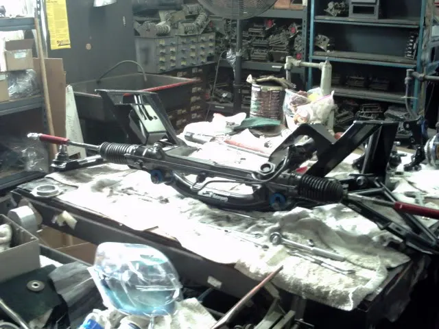

**** the stock springs, those piles of **** are just that, when i was taking my car apart i got hit in the ****i chest with one of them, and people here are saying that you need 2 or 3 or 4 people blah blah you dont, i built my entire car by myself, just attach everything to the k member before you put it in the car and everything will work much easier
