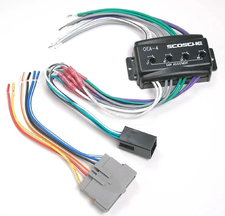

is this the crossover thing their talking about? if it is, it looks like a peice of cake to install and it comes with the wiring harness. Its only 39 bucks. I'll be dammed if I let best buy rip me off 80 bucks.
http://www.crutchfield.com/S-Bd3TMMfmboE/cgi-bin/ProdView.asp?g=751&id=essential_info&i=142C4FDK5

yeah that is the adapter I used on mine. I went through crutchfield and they will tell you everything you need and is a piece of cake to install yourself. Is your the stereo with the in-dash 6 disc? If I remember correctly, they don't make an adapter for that one yet, at least they didn't within the past year. I had the stock stereo with the single cd. I think in 01+ they changed to the 6 disc and there is something different about that one. Go to Crutchfield.com and enter your car year, make, and system type and they will come up with everything you need to do it yourself.

Yeah mine is the in dash 6 disc changer. Outputs are outputs I dont see why mine would be any different from the 01 with single disc? After all that adapter is for models 88 and up. I'll call crutchfield tomorrow to clarify this. Thanks for the info.
