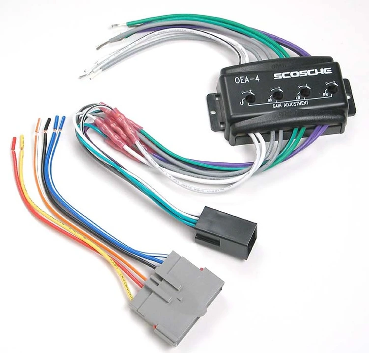

is this the crossover thing their talking about? if it is, it looks like a peice of cake to install and it comes with the wiring harness. Its only 39 bucks. I'll be dammed if I let best buy rip me off 80 bucks.
http://www.crutchfield.com/S-Bd3TMMfmboE/cgi-bin/ProdView.asp?g=751&id=essential_info&i=142C4FDK5
I recently replaced my Mach 460 deck with a Pioneer & that adapter, both from Crutchfield. The black plug coming out of the adapter connects to the speaker harness in the car. It was not a good fit; the wires kept pushing out of the back of the Scosche plug, losing speaker connections as I was driving. After trying two adapters, both with the same problem, I cut off the plugs for the adapter & the car's harness & hardwired it up. No problems since.

The wiring harness that is needed for a 01+ is the MET 801771. This is all one plug, but to do the same thing I mentioned before just cut the white, white/black, green, green/black, grey, grey/black, purple, and purple/black wires and run those to the RCAs. Tape off the end going into the aftermarket HU, and the other end is the one to run to the RCA preouts. Same concept, very simple to do. Now, does anyone else need their car washed with my "dirty rag"?
