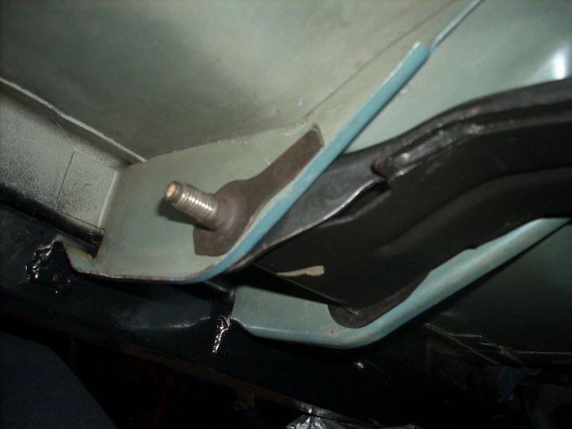

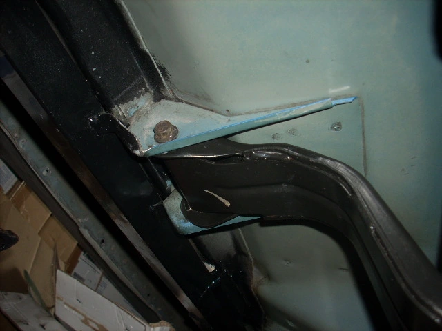

I finally got the trans in! What a pain! I got the cross member bolted and how tight should the bolts be? The bolt is all the way through but still turns a little bit. Do I have this tab on the right way?
