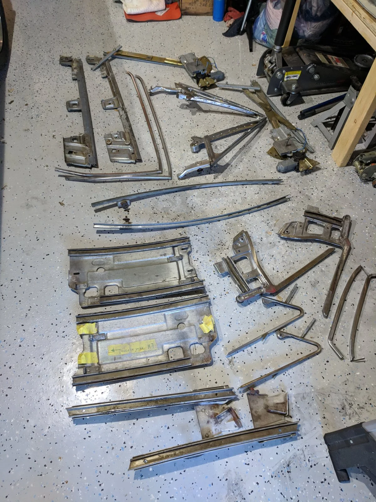

As things stand right now I have everything that comes apart is apart. The glass is out of the rails, no weatherstripping anywhere, and I intend to install my own vent and quarter glass into the frames.
Here's what I have laid out in my garage right now...

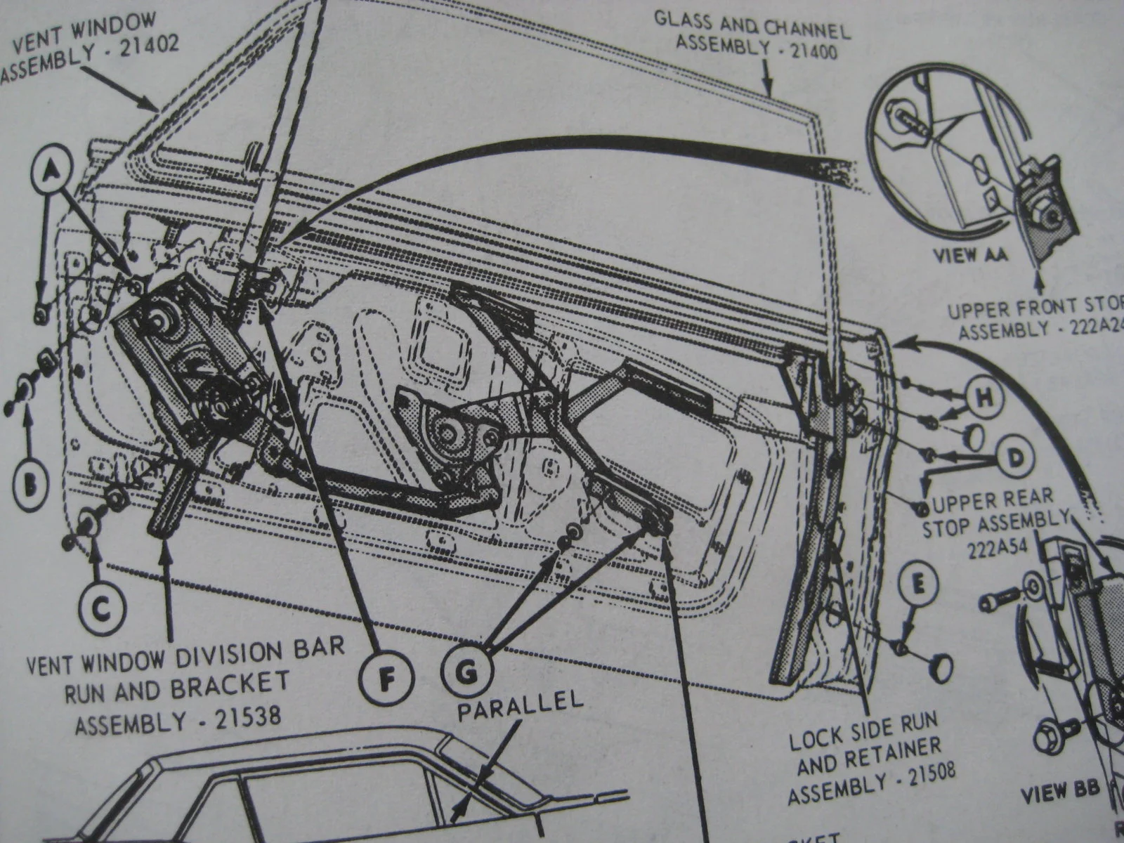

I reached a stopping point when I could not figure out how I am supposed to get the rollers (rear run) lined up while the vent window is in, same goes for the rear run...cannot see how I can line up the front section with it in place.
I'll check out the Cougar video, maybe it shows that, if not ...has anyone done this and can tell me the trick?

it deals with a 65/66 which are not that much different but in the section around 11 minutes into the video he's trying to get the glass off the rear rail (where the rollers ride in the C-channel), which is pretty much my problem. He's able to wiggle it out by loosening the rear run. On my '67 the C-channel goes almost all the way up top where the belt-line weather stripping would be, no amount of loosening is going to allow those rollers to pop out from the top of the channel like that.
