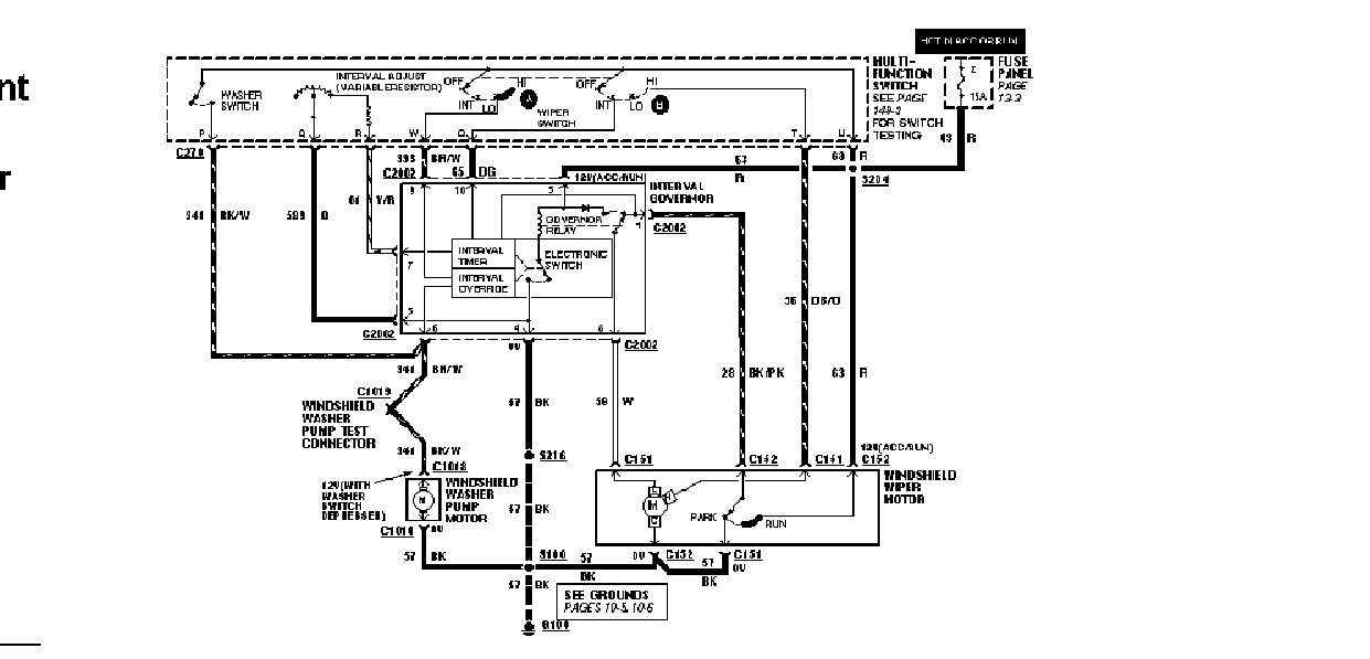

Windshield wipers – how it works theory and operation
Multispeed windshield wiper operation

1.) Look for constant 12 volts on the red wire on the wiper motor. No 12 volts, the fuse is blown, bad wiring or bad connection. This will cause park problems or no wiper operation
2.) Check the ground. No ground and nothing works, bad ground and you get intermittent operation.
3.) No high speed operation, low speed OK. Look for 12 volts on the Dark Brown/orange wire. No 12 volts, bad wiper switch, bad connections or bad wiring.
4.) No low speed operation, high speed OK. Look for 12 volts on the white wire. No 12 volts, interval governor faulty or missing, or bad wiring. Since this is a pulse and not a steady voltage, a test light used in parallel with the voltmeter may be a better indication of operation
5.) Motor low speed test: Jumper the brown/white wire on the interval governor to the white wire. The motor should run in low speed mode. I haven’t tested this yet, so use caution. If the motor does not run, the low speed brush may be bad.
