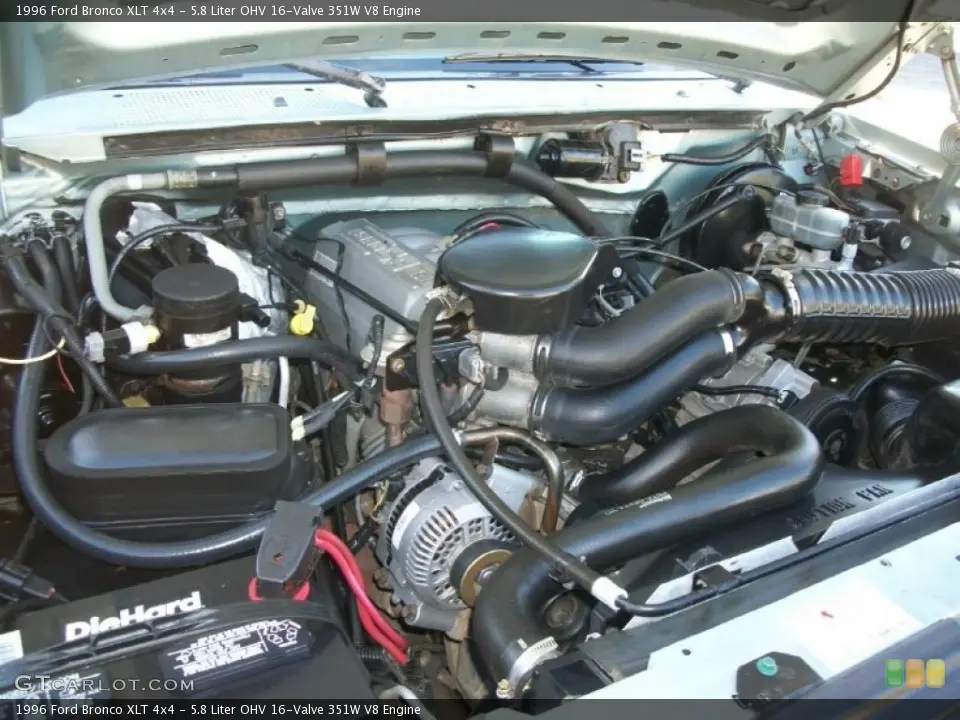

Well I have a cobra intake that is different but I haven't seen the 351 yet the images I looked up there is two different kinds one over and one square the ovel one looks like a stock 302 upper intake will work

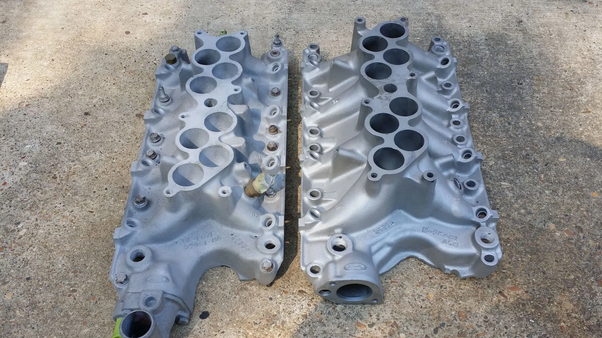

No, the 351 truck intakes are unique. A HO upper won't bolt to them. The lower intake of the 351 is also wider than a 302 intake
For example, GT40 lowers:
302 on left, 351 on right

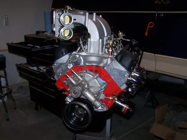

ok will a stock 5.8 intake with dual throttle body intake off a 1992 bronco fit under the stock cowl hood of a foxbody?
need help asap
something like that!!!!
Mustang5L5
Mod Dude
Feb 18, 2001
43,347
18,082
224
Massachusetts
Jun 12, 2017
  • Jun 12, 2017
Nope
That sucker is tall
