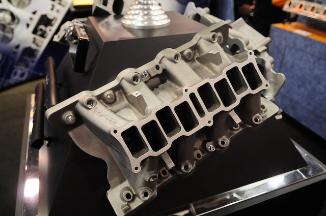

TFS runner pattern
Stock runner pattern
You're not going to put one on the other.

here are some pics of both
TFS Track Heat lower
Google Image Result for http://www.collectorcarsforsale.com/parts/parts-images-large/1986-1995-ford-mustang-5-0l-302-trick-flow-efi-intake_170643245214.jpg
Stock Lower Intake: Google Image Result for http://i21.photobucket.com/albums/b272/ShoeiIto/Picture005.jpg
check out the runner shape and where the temps sensors are.. also around the distributor.... they look kind of the same at a glance but take a good look..hope it helps!

you can buy the upper only because the tfs street heat and track heat intakes use the same tfs lower with a different uppers, and are interchangeable/upgradable. they will NOT bolt onto a stock/cobra/gt40/holley/eddelbrock/anything else, only the 1 lower. and the tfs lower pictured above looks like an r-model, its similar to the normal tfs lower (same basic design, but bigger), but it also wont take the street/track heat uppers.
