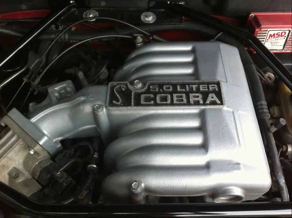

Last of the titans indeed. Look at your stock manifold where the throttle body connects. The 94/95 cobra has the same bend. If you don't go w a 94-95 cobra intake no matter what intake you use you'll have to get an elbow adapter.
