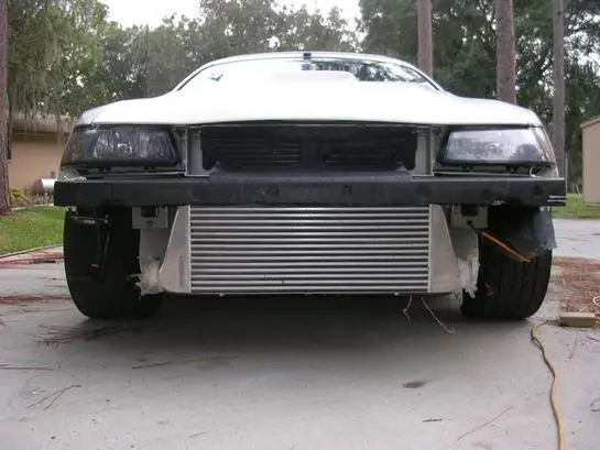

they sell a 28" x 10.5" x 3.5" intercooler for $250. (isn't listed right now, but email him and he will put it up i'm sure. He also has a website listed on his ebay store. Prices there are about 10% higher though.) Still a far cry from a grand.
I have installed several different size intercoolers from this supplier and have had no issues at all. Quality is top notch! I run it on my own car.
see....
Well with 11.25 psi with stock heads cams intake and exhaust manifolds I put down 431/419 @ 16* of timing.. But after the dynoed I found a small leak and replaced a couple restrictive silicone elbows and I now average between 13.5-14 psi now. I even added LTs after the tune and I still average 13.5-14psi. I'm running a 2.8" rr 6 rib pulley I got off ebay for 35 dollars. I do see belt dust. I was 371 before the ic and smaller pulley. I was running a 3.3 10 psi but had no belt slip.
My power level is in my sig. I get 0.5 psi drop.
