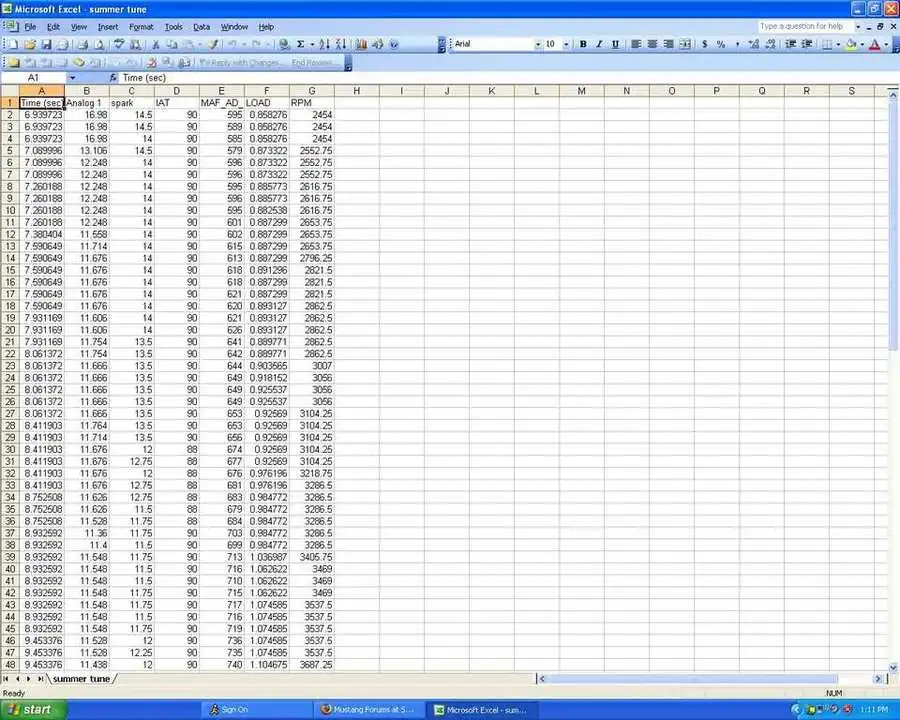

Those fools are installing the IC in the wrong places. My IC has helped a TON. I logged my IAT when it 100+ degrees outside. At WOT, she logged 100^ IAT. When my car was NA, it ran 140 at IDLE when the temp was 100 outside. IC's are definitely safer for the engine. Engines don't like heat. And with a blower, your adding more load to the engine.

So 100+ degrees outside temperature, At WOT, she logged 100^ IAT. So your IC has 100% efficiency. This at what boost pressure? Can you post pictures of this system?
That was boosting about 9-10 pounds. Here is what I logged when it was 95-100^ outside a little while ago:

Very Nice
