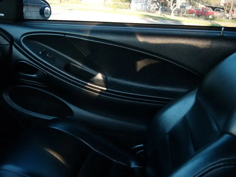

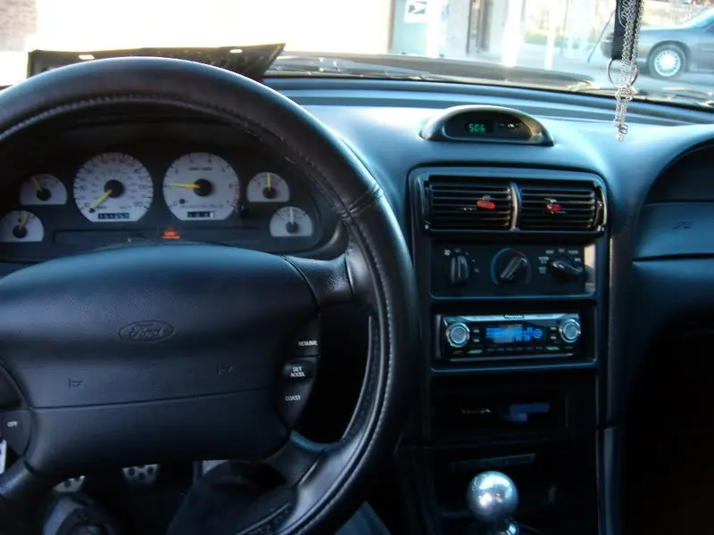

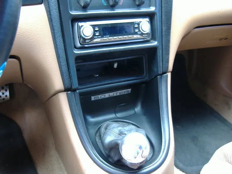

here's what i had before (infamous black & saddle, clotch seats):

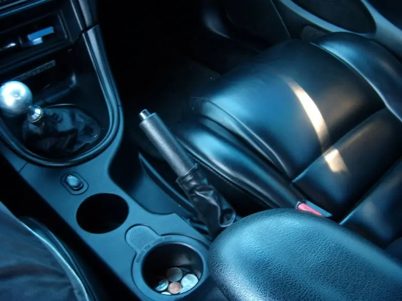

after painting (new carpet, new seats, rear-seat-delete, 01-04 center console w/ leather shift boot and ebrake boot, etc):
totally worth it

the console, i got at a junk yard for $50. i bought an extra in case i screwed the first one up, but didn't. hell, i even sprayed the ebrake boot with the Duplicolor spray and it's held up perfectly!
totally worth it
