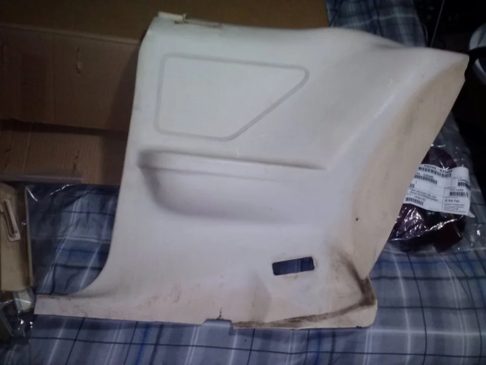

Here, you can see what I'm starting with. Like I said, they're in pretty good shape, as you can see here on the passenger side panel, but they're a bit grimy.

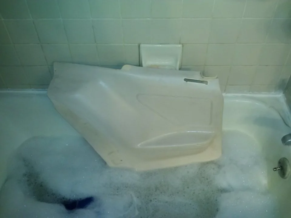

To clean them, I started off with a rinse with warm water, followed by some scrubbing with a terry cloth towel, warm water, and Palmolive dish soap. This got the majority of it loose pretty quickly, but there's some stubborn stuff that just wouldn't come off, as you can see here on the driver side panel.

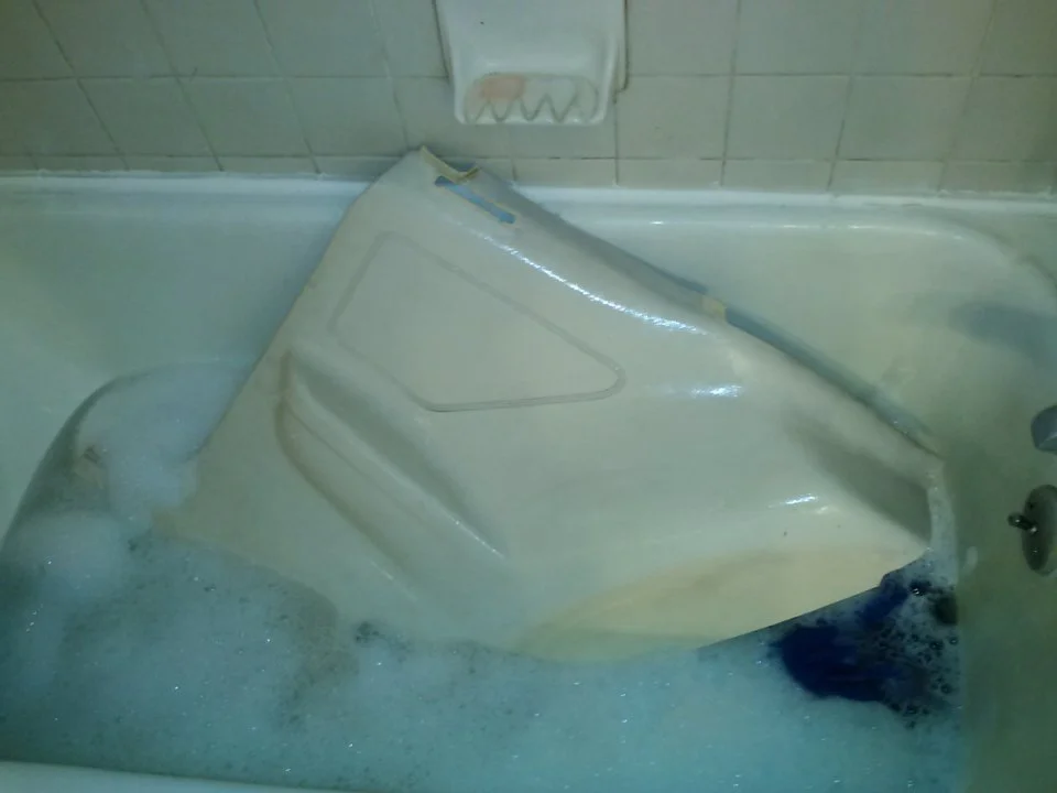

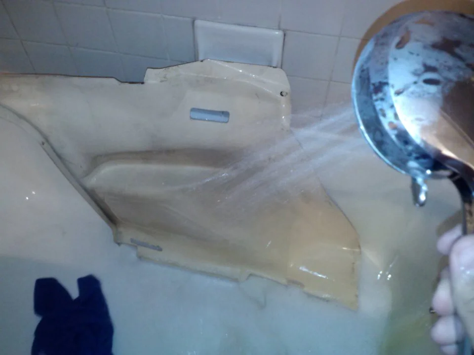

The passenger side panel's dirt was more stubborn, here I am rinsing the back side of it again to see if a little water pressure from the "massage" setting won't knock some more of it loose. (One of the benefits of being single is you can use your bathtub for things like this!)
After some more time scrubbing and rinsing, we have a pretty clean panel. I'm going to do some detail cleaning later, and I'll update the thread when that's done, not to mention the rest of the steps involved.

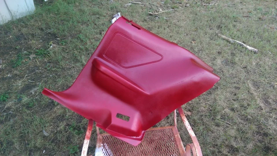

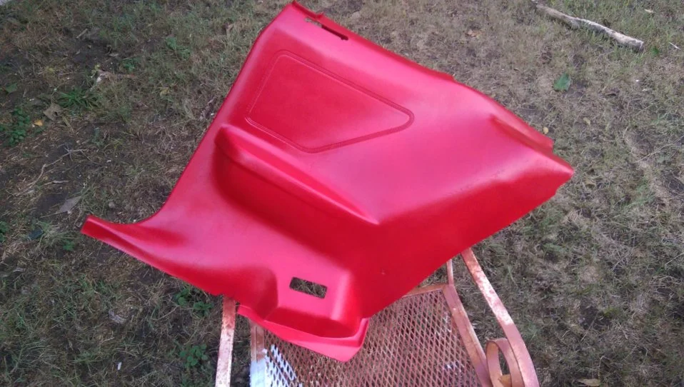

First coat done. Dupli-color seems a bit off on their shade of red. I'm going to apply another coat tonight and see if it darkens up enough (if at all), and if not, I will be on the hunt for a darker shade to correct the issue. As you can see though, the paint laid down nicely, even on plastic, thanks to the adhesion promoter!
Stay tuned!
Another coat of paint darkened it up quite a bit! It's looking like one more coat will have it done.
The paint ran just a little at the bottom of the panel, but that will be hidden under the rear seat cushion, so I'm not going to fight with it. If anything like that happens anywhere that will be visible, I'll be working to correct it, and if end up doing that, this thread will become a bit more involved.
