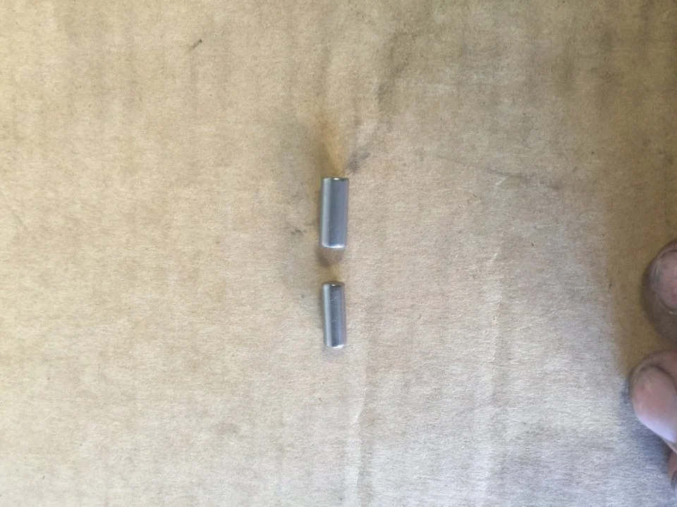

Well any way when I got the car. I had issue grinding going into 4th. I have done a rebuild this weekend. Wasn't to bad at all. Synchro swerve all toast. But I have a slight issue reassembling. I have a pin left over. Is about the side of the needle bearings that are in the input shaft but slightly smaller in height and diameter. I thought it was a pin for the 1st gear sleeve, but I have the ball and spring in there. When taking the trans apart, the ball and spring and this pin showed up on the work table at the same time, I noticed them at the same time. I kno the ball and spring fell out and I found it.
Right now trans is fully assembled but before I put it in the car I wanted to see if I did something wrong, or if this pin even goes to the trans
Picture attached. Pin in question is on the bottom. On the top is a input shaft bearing for size comparison

The one is a roller bearing between the main shaft and input. I put for size comparison
Found out the pin was used for 1st gear sleeve. The ball and pin went under the 1-2 slider on the main shaft. She is all ready to go now.
