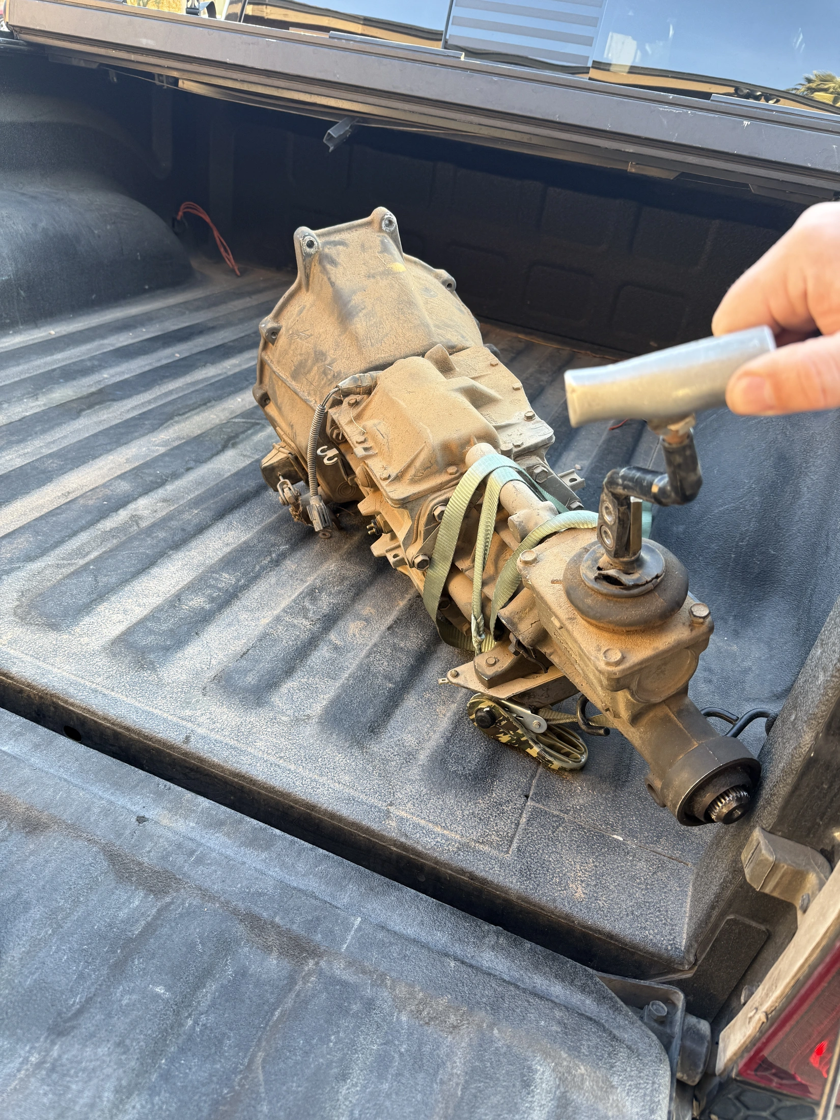

Hey all, long time creeper first time poster! I recently picked up an 86 Lx to build a drag car. No motor or trans. I picked up a t5 that came out of another fox but was paired to the 4cyl.
My questions are…
1. Can this trans be equipped behind a big block?
2. If it would work, What else would I need to update besides the bell housing and input shaft ?
Thanks so much for the help!
If its the 4 cylinder transmission I " believe" it has different gear ratio's than the standard T5.....
Someone with more knowledge will come on here and help

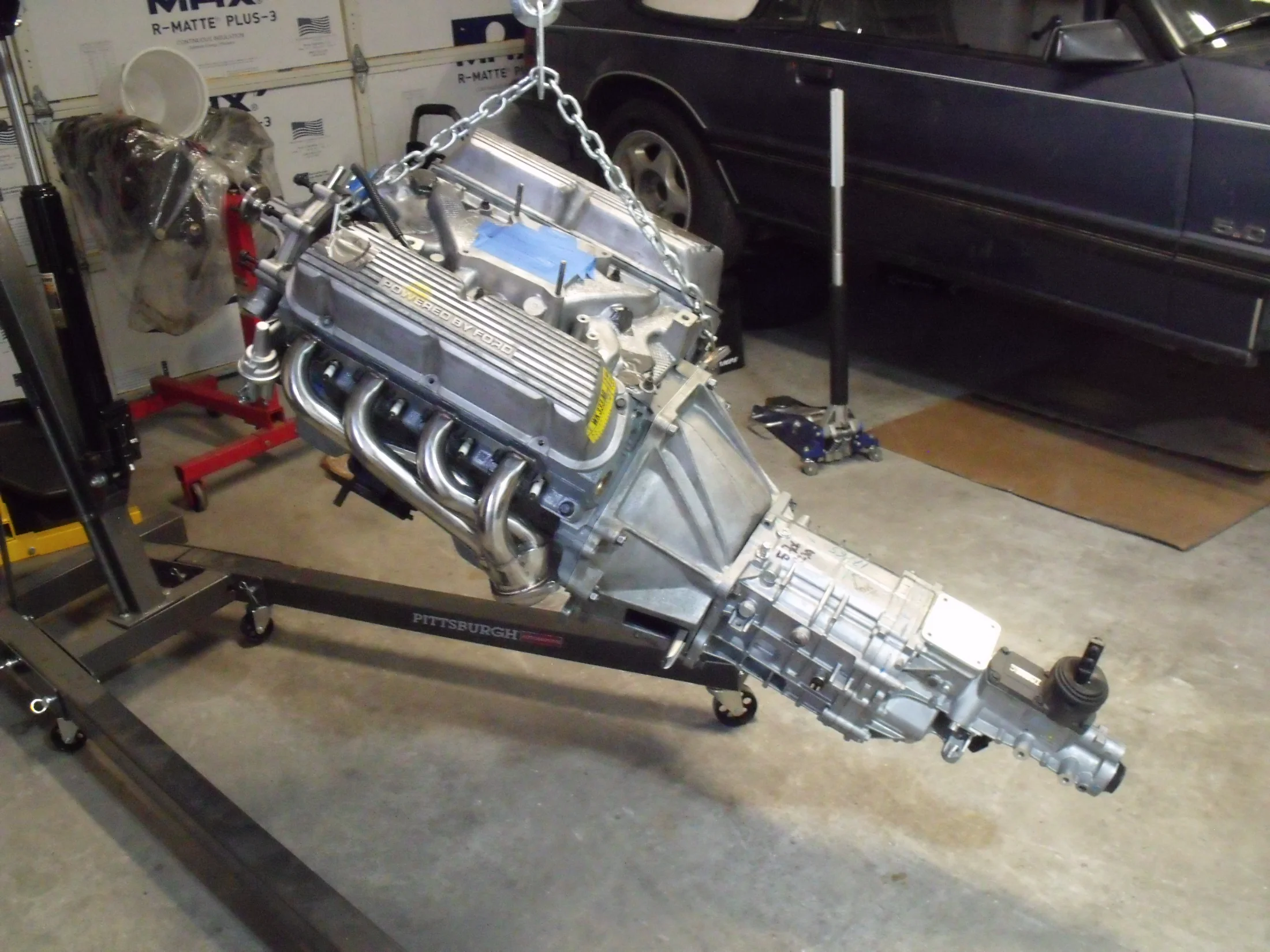

This one is a popular upgrade and could probably handle the stresses.
