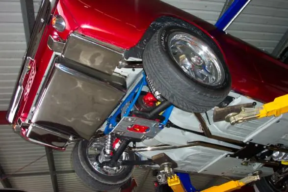

I installed a jag in my 66 several years ago and it drives great. Kept it in the origional cradle to maintain the geometery. I can recommend it.
Marshall
