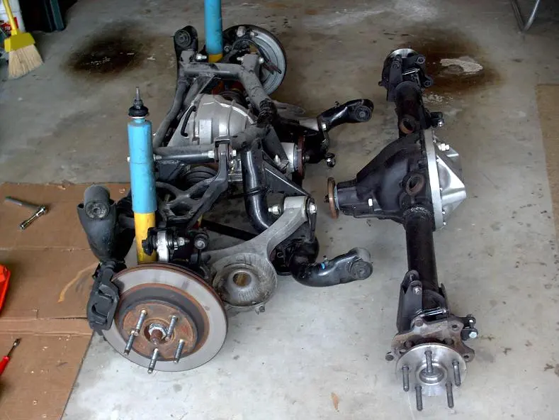

Picture of an 8.8 sitting next to a IRS from an '03 Cobra. I can see 150lb difference...

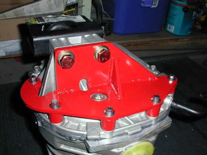

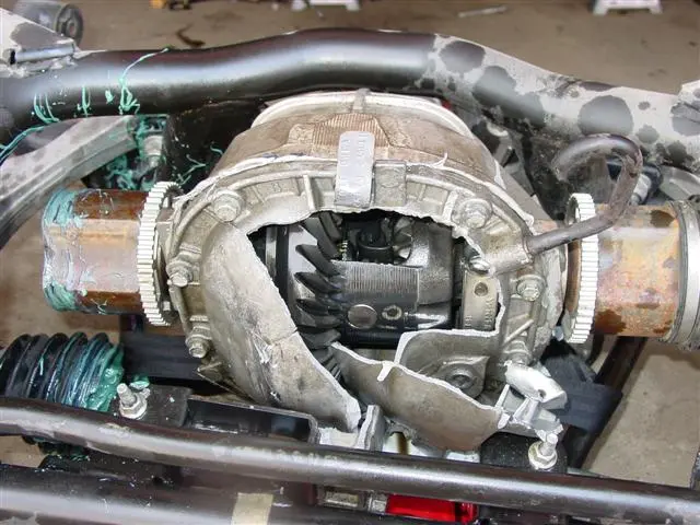

If you plan on running it at the track occasionally you might want to think about an IRS brace so you don't bust up your differential cover.
This part...
Helps prevent this problem!
Now there are guys who've been beating the snot out of their stock half-shafts with 500 or mor RWHP and never had a problem. There are also some poeple out there who have snapped the stock half-shafts with a stock Terminator on the street. :eek:

U.M., I don't think you are comparing apples to apples in this photo. The 8.8 in the pic shown doesn't have brakes, shocks or upper and lower control arms, all of which are on the IRS piece. That's not to say that the solid axle isn't lighter, it is, I just don't think this picture gives an accurate representation of the differences.
