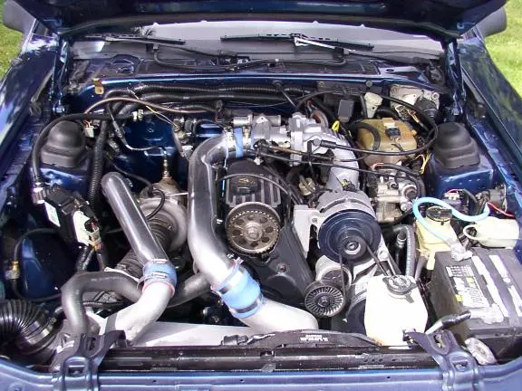

I have 2 1/2" pipes on mine. They are a little hard to fit under the hood, but they work great.

^^^ That's more or less how mine is going to be set up, except i'm gonna shorten the straight piece coming off the TB so the pipe isn't sitting over top of the turbo...that'll give me extra hood clearance if i can get that pipe to run parallel with the exhaust manifold. I just don't know yet if i can fit the IC in front of the radiator with the inlet/outlet on top like that...i may have to run it upside down and end up with longer pipes.

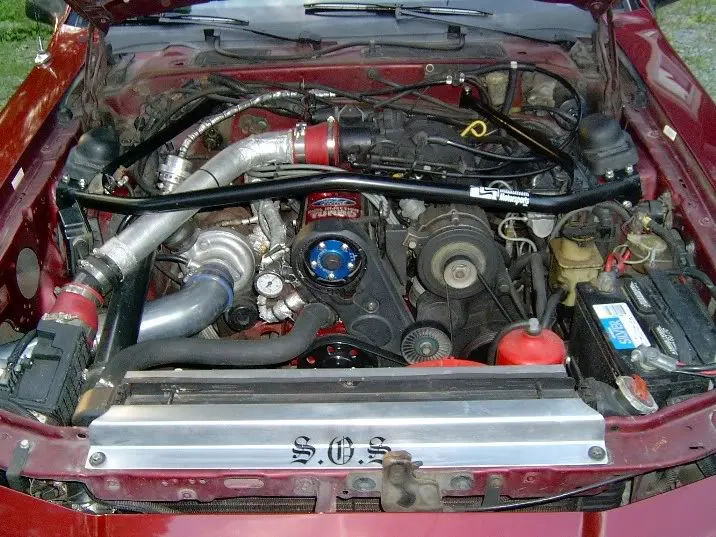

Mine is like this:
And I don't have any clearance problems at all.
Course, I know that anyway because it runs under the STB, which kinda has to clear.
