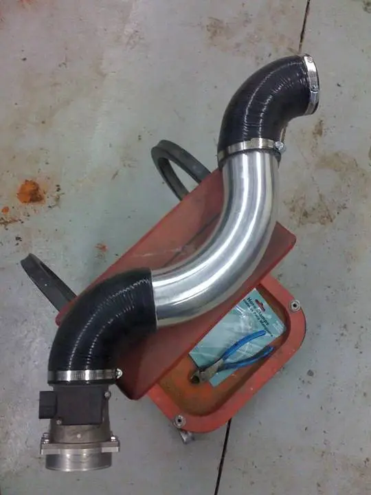

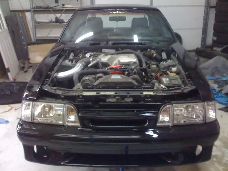

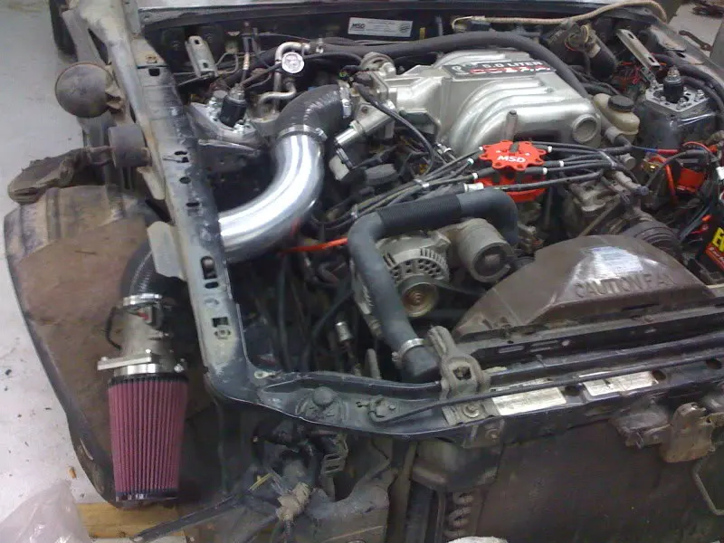

Damn cenok where did you get that pipe from?? Did you have to bend it and stuff? I dont have the equipment to bend any metal. What kind of MAF did you use? Is that just the 94-95 maf?
Would you consider making another one for some cash?

I went on ebay and bought 4'' uj bend, cut my hole in my inner fender to 4.50 inch. put a insulator around the hole and cut the bends at the right angles with a metal chop saw and had them tig welded at a local speed shop. Very easy to do if you have any fab skills! I have built many intakes for many different cars/trucks very simple! i used stainless but if u used mild steel you could keep your cost really down there.... Custom Intake Parts: Intake Hoses, IntakeTubing, and Intake Clamps is the company i used to get the special elbows hope this helps good luck
