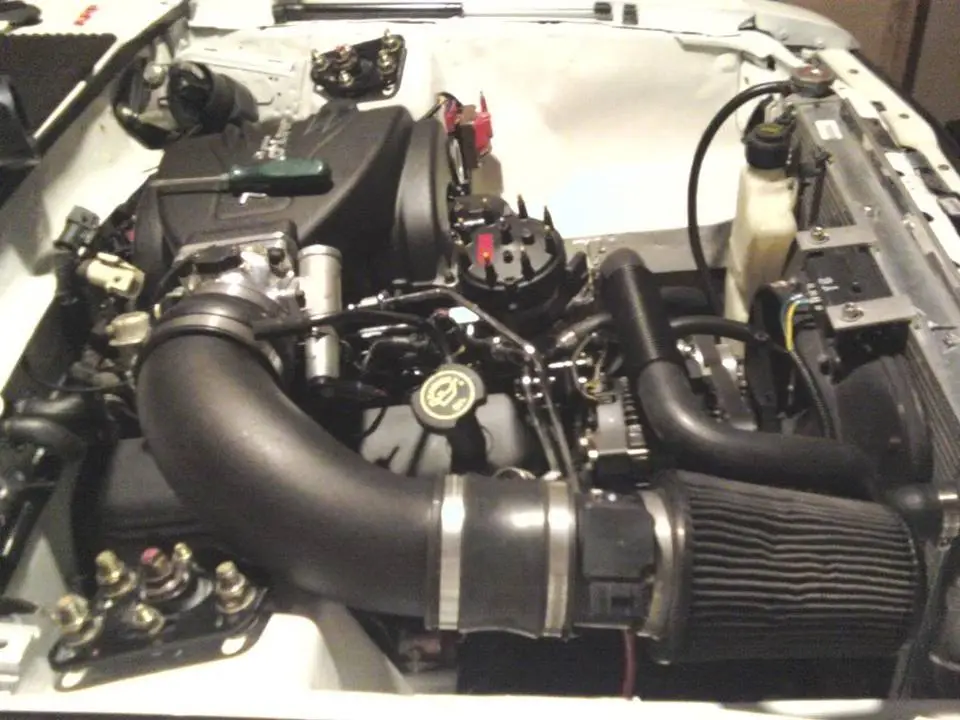

the way i see it is that you want to get as much air into the engine as possible, people told me that a 90mm tb and 4" powerpipe was overkill and i would loose all my low end with the big pipe and too much cylinder head... Well if you look at my dyno sheets you can see that im giving up no TQ. down low, and the motor feels pretty f9cking snappy to me.
But for your setup i think the 3.5 pipe is the correct choice, but i dont think that if you put a 4'' pipe on the car and drove it you would notice much if any difference
mine is 4 1/4" works great! plus works as ram air!
serious tho
and my buddies 3 1/2"
peace
john:p
mine is a 351w 40 over AFR 185 58cc heads L/T's trick flow R upper/lower intake 42# injec voodo flat tappet cam MSD dizzy crane gold race rollor 1.6 rockers accufab 90 to 75MM throttle body 90 LMAF no P.S,A/C, anything else just alt and water pump. his i caint disclose but it's nice! :nice: peace
